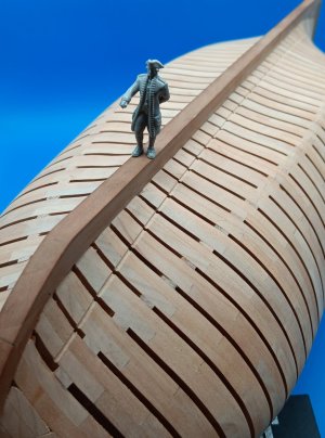

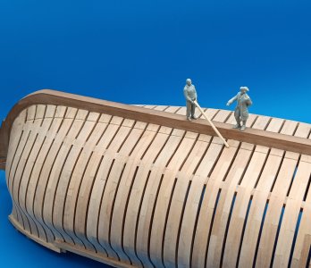

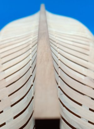

18 days caressing with rasps, sanding sticks and scrapers and the lines of "Salamandre" have appeared. Some small blemishes but overall, I'm satisfied.
Next up, the eel channels.
Bow:
Stern:
View attachment 573173View attachment 573174View attachment 573175
midships:
View attachment 573171View attachment 573172
Sideview:
View attachment 573176View attachment 573177
Ovrhead:
Interesting view of the stern:
A low spot that needed filling:

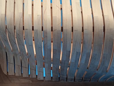

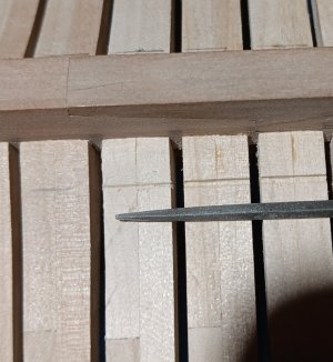

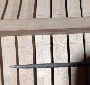

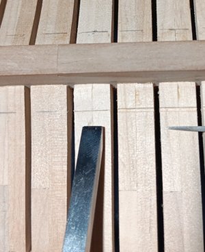

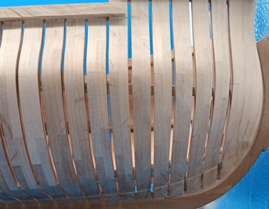

Started experimenting with the Limber Channels (eel channels).
It's terrifying to cut a gouge in every frame, that took 18 days to fair smooth. I needed a foolproof, repeatable method before cutting the channels.
Many beautiful models omit this detail (possibly, the builders are also terrified of marring a beautifully faired hull)??
Below process is very basic stuff. I want to help anyone by sharing the method this shipyard came up with.
1. Below photo shows how small a 4x4 inch limber channel is. A square jewelers file is shown next to the channel.
2. Shipyard laid out a line, then used a sharp chisel to define the centerline of the channel.
3. Next a triangle jewelers file increased the depth of this chisel line.
4. A few passes with a round jeweler's file increased the width and depth slightly.
5. Next a rough #2 cut round rasp quickly cut to the final depth and width.
6. A round file smoothed the edges.
7. The chisel squared the round edges.
8. Finally, a few passes with a square jeweler's file gave a square 4"x4" limber channel.
6 minutes/frame x 86 frames = 516 mins (estimate 8.5 hours to do all the frames).
Sorry for the long post. This worked for me and I hope it helps someone else in the future.

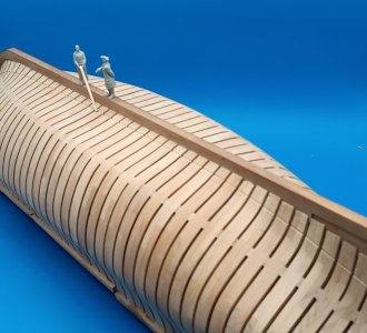

Three New updates!
1. 6-year-old granddaughter's inoperable, brain tumor, finally showed signs of shrinkage! 2mm after 4 months on a new chemo regimen! Prayers for continued shrinkage are welcomed!

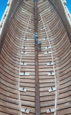

2. Two different 3D figures, from Kiev, arrived today. They are available in any scale and very detailed. Here is a link: French Officers. Below shows the Shipyard Superintendent and PO Brutis reviewing the Limber Channel progress.
3. The Limber Channels were completed! 2-hours/day, while babysitting our 3-year-old grandson (naptime or after bedtime). Some views:
20260130_173155.jpg20260130_173741.jpg20260130_174527.jpg20260130_174653.jpg20260130_174804.jpg

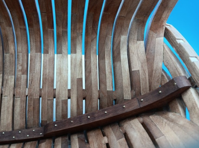

Treenail experiment, for the wales.
The ones on the right are from "Safeway" brand toothpicks and take seconds to make.
The ones on the left are from pearwood and take much longer.
Dimensions:
Hole drilled: .033inches = 1.58". Slightly oversized (actual treenails would be about 1.1-1.3"). But smaller and I'll be breaking drill bits left and right!
Barnes draw plate hole #41
As far as I can tell in these pictures the toothpicks (right) look just as good as the pearwood, so toothpicks it will be!

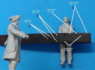

A plan is developing!
My thoughts:
I believe French Wales would look like A.
Why? I think the bolt heads would be countersunk and covered with a plug/wood bung.
Why would bolts be covered and not exposed?
1. To prevent corrosion from salt spray.
2. To prevent gouging and scraping piers or other ships tied alongside.

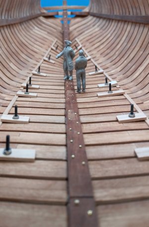

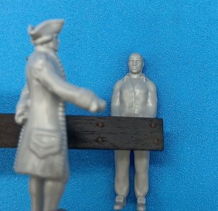

I believe major interior structures (Keelson, Riders, Bow Hooks, etc) would look like B.
Why? The bolt head would be left exposed, since they wouldn't be rubbing against other ships/piers/etc.
I like the square shoe-nails that arrived today so much I may redo the round bolt heads on my keelson below, IF I can get them out easily!
My "Artistic License" plan? Use C and D, to copy the beautiful method Tobias used on his "Le Rochefort"
1. Below the Wales: Bolts and Treenails of .024-.025" (scale: 1.15-1.2") alternating, sanded flush.
2. The Wales: Bolts of .025" (scale: 1.2"), sanded flush. I like the effect, especially against the dark ebony wood.
3. Above the Wales: Treenails of matching wood for a very subtle nailing effect.
Any feedback or thought appreciated.
These are the keelson bolts I MAY replace, if I can get the round ones out.
