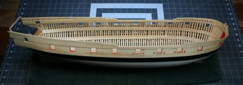

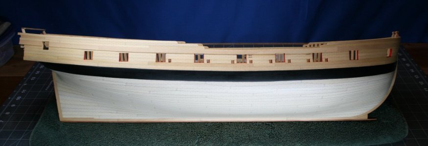

I also intend to cut at least two, but probably three or four viewing ports, similar to the below photo (my wales will be three solid ebony planks):
Paul, thanks!! I followed that build and love the outcome. My favorite shot from the above pictures is the bow shot, but they are all inspirational!
There will be lots of thought, time, gnashing of teeth and experimenting, till the shipyard comes up with a final planking and cut-out plan.

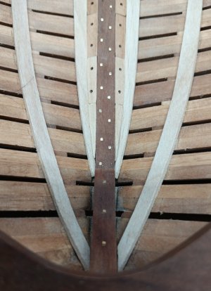

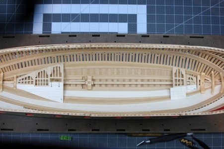

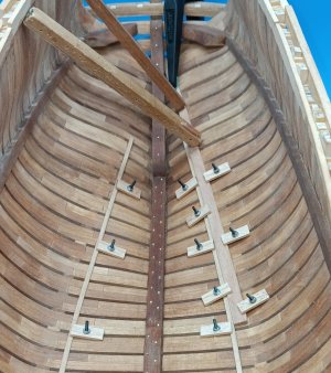

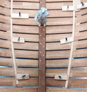

Accomplishments.
1. All square bolts are installed.
2. The first plank of the "thick stuff" was installed.
3. The Limber Strakes were installed.
4. Access planks to the Limber Channel were milled and placed.
Shipyard Superintendent approved the lay of the thick stuff and limber planks.

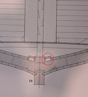

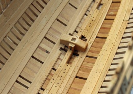

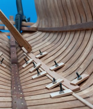

Boudroit depicted the access panels to the Limber Channel below. I didn't like this French method of laying the access panels.
Using the Shipyards "artistic" license, the panels were placed in the same manner as Toni did on her build of HMS Atlanta (below).
I know this is the British method. However, PO Brutis is an "impressed" British Prisoner of War and he convinced the shipyard this method is simple, effective, stronger and more secure.

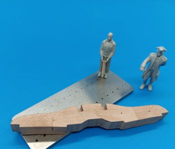

First a jig was made to uniformly build the panels. The holes are 3", which is large enough for a hand to grip but too small for a foot to fall into.
Close-up of the finished product and also the final tapered filler piece.

Accomplishments.
View attachment 577785 View attachment 577784
Thanks for visiting. Shipyard slowdown anticipated as G'ma/G'pa are having a sleepover with BOTH our 3 and 5-year grandkids :D !

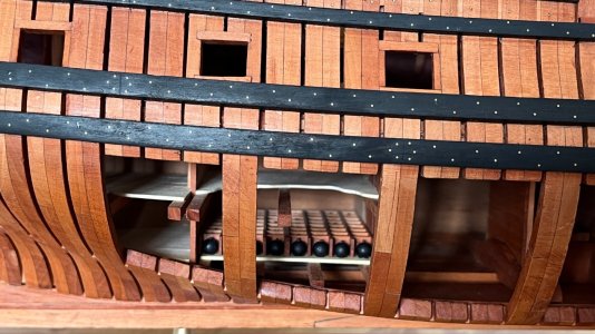

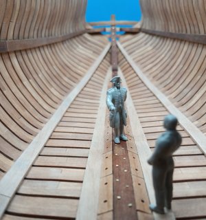

Nice work on the panels, Brad. They fit nicely in the recesses. Also, the color combination of the wood and the square nails.
That's sort of what I did on the KF. Here are some images so it will help you visualize (these are full-size images and will open to a larger size if you click on them):
View attachment 576254View attachment 576255View attachment 576257

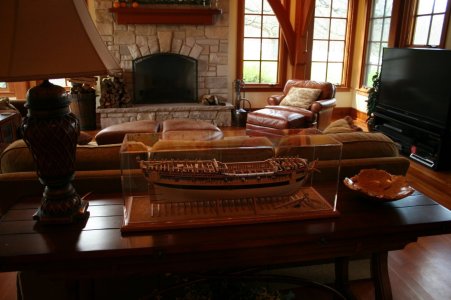

If you haven't got the space to present her in a four sides glas shrine:
What If you build a showcase with the starboard side to the front, sides and top - and a mirrow as the backside?

Chris - The lovely ship is Paul's build (dockattner). He has it in a beautiful case, sitting in the launching ways. Here it is in his home. Take the time to review his build log of the Kingfisher, it is inspirational.

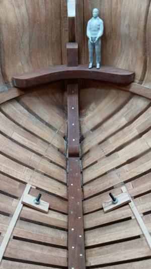

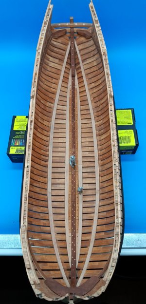

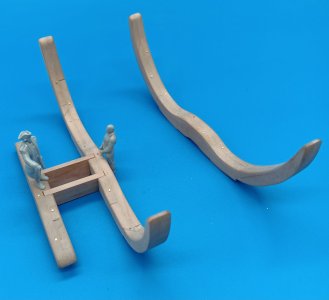

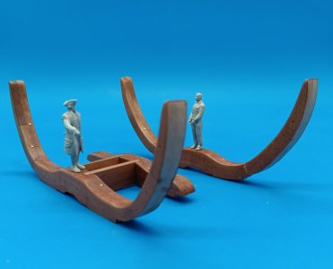

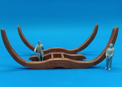

Risers and mast-step box....the result of eight days in the shipyard:

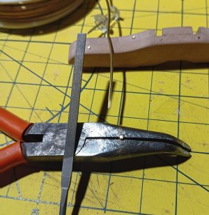

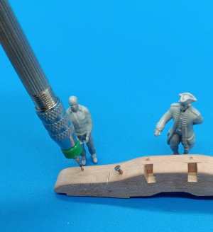

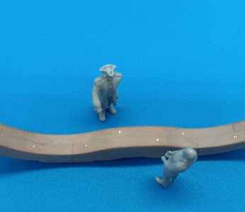

Step by step details on the bolts I simulated (for those interested or just learning):
1. On the sides, I used treenails. First, the tip of toothpicks were drawn through the Brynes Drawplate holes 36 to 38.
2. These tips were inserted into a 0.8mm hole and clipped off with nail clippers and sanded flush with 400grit paper.
3. For the "bolts" on the top of the risers, 1.0mm square brass wire was cut to 3mm length and the top was burnished flat, with a jewelers file.

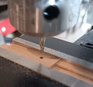

4. This photo shows (left to right):
a. Drilling a 1mm hole.
b. Squaring that hole with a 1mm square shoe nail.
c. Gently guiding the 3mm long square "bolt" into the square hole.
d. Finally, the "bolt was pushed till is sat just proud of the riser.

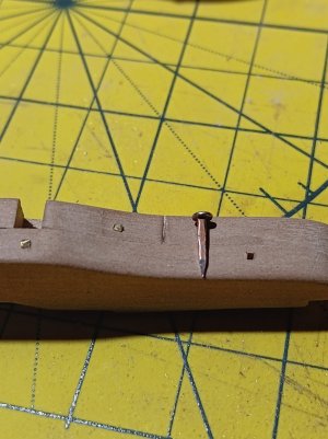

5. This is a closeup of the 1mm shoe nail. I ordered a 1lb box, thinking they would be perfect.
HOWEVER, after I got them, I realized they were steel and I was concerned about them rusting over time, so I opted for the square brass wire.
6. A photo before staining.
I will use WATCO Dark Walnut to highlight the main structural elements (all pear-wood), like the risers, keel, deck beams etc. It brings out the grain nicely and the contrast of the dark structural pear wood, with the lighter elements like decking/bulkheads/etc., gives a nice effect.
Thanks for those who've made it this far!!
