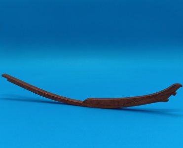

The Boudroit plans show a significant taper on the knee of the head, which I included. I haven't seen any tapering of the stern post or keel in the drawings.Do you know if the stern post, keel, and knee of the head tapered in breadth like on English ships? The dimensions are given in the scantlings for the Establishments, Steel, and contracts for English ships but I wonder if this kind of information is available for French ships.

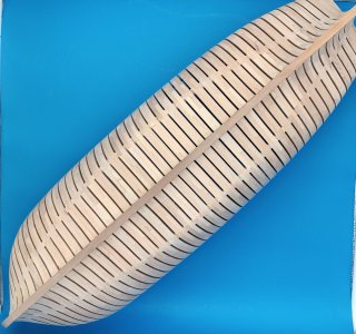

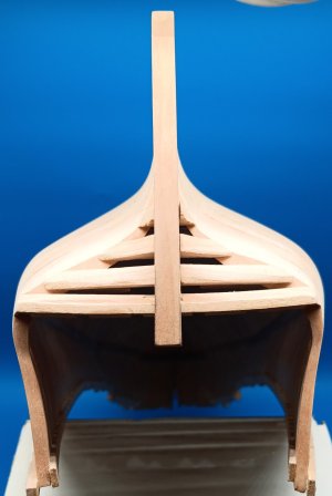

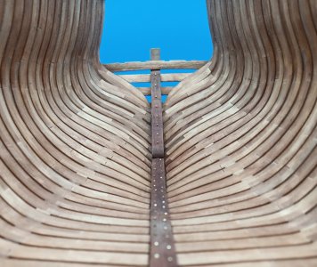

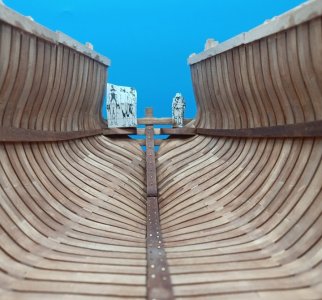

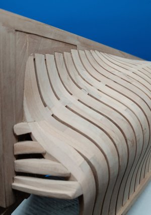

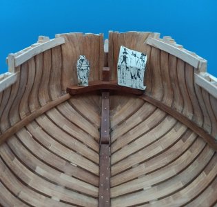

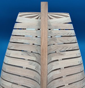

Wow!3rd redo of the Stern Cant frames completed!!!!
Turn of the bilge frame spacers were also added.

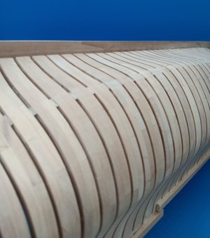

The entire interior is faired and sanded.
Will oil the interior this weekend.

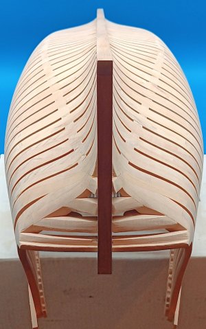

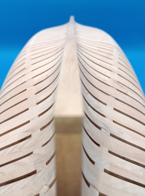

Longitudinal stiffeners at the top of the frames were added, both inboard and outboard. She is very solid now, so sanding the outside can begin soon. 5lbs of copper bullets keep the keel from hogging!

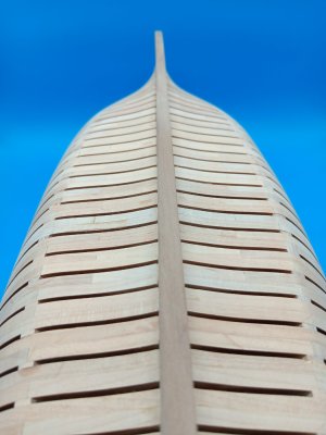

Nothing more satisfying than running your hands over a faired hull. Enjoy the process!The hull is now rigid enough to begin the tedious but rewarding job of fairing and sanding the outside of the hull.
Only if “faired hull” is a euphemism for something else…Nothing more satisfying than running your hands over a faired hull. Enjoy the process!

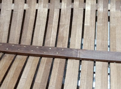

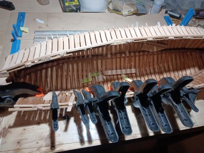

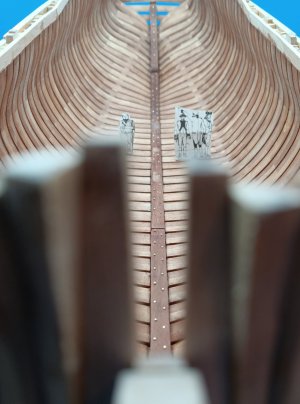

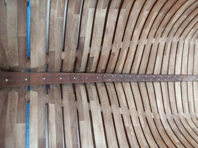

I had to catch up ‘some posts’ but this is looking very nice, Brad.Main Longitudinal Deck Beam Ledges installed and level. on the second attempt. The bow/stern Hooks were completed!

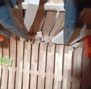

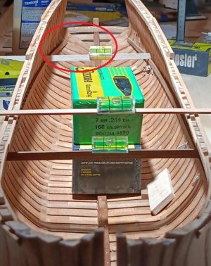

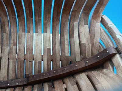

The deck beam ledges shifted after I applied the numerous clamps and ended up being off slightly when the clamps were released. The shipyard is getting good at deconstruction/reconstruction. Some photos of the process:
1. Can't have too many clamps.
2. Finally used the micro screw clamps I discussed making, earlier in the log.
3. The FAILED bubble check for level along the build. After unclamping, the Stbd Deck Ledge had slipped lower and lower toward the stern and was off by just over 1mm. Probably could have just cut the deck beam notches 1mm deeper on port side, and the beams would have been level but wanted to "get it right"!!

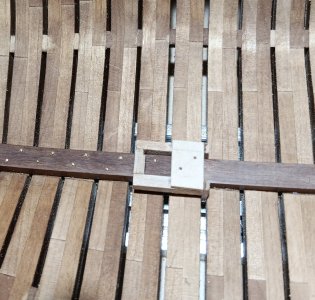

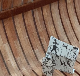

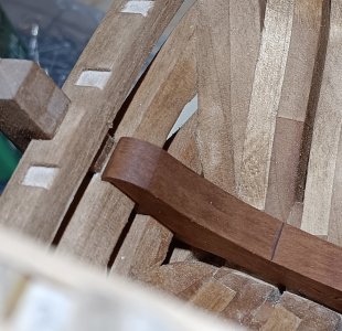

4. Shipyard Inspector tells LTJG Newbie that PO Brutis did a nice job on the Scarph Joint below:

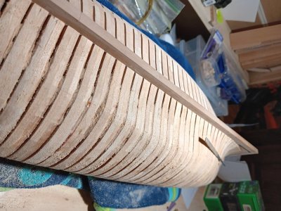

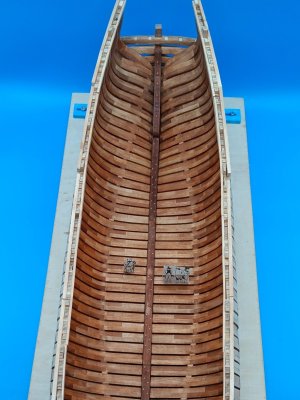

5. Main Deck Bow Hook passes weight test inspection.

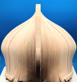

6. Top Transom Stern Hooks installed and inspected. The slight rise of the deck aft is clearly visible.
Thanks for your interest!
Looks great Brad - looking forward to seeing the results of a nicely faired hull !
Only if “faired hull” is a euphemism for something else…![]()
Absolutely clean work Brad, the hull looks fantastic from the inside.
Thanks all for the nice comments.I had to catch up ‘some posts’ but this is looking very nice, Brad.
!Absolutely love this!! Ungluing and repositioning the deck clamp (deck ledge) was great to see. Many of us have been there and it is hard decision on whether to redo or go the easier route and cut notches in the clamp or beam.Probably could have just cut the deck beam notches 1mm deeper on port side, and the beams would have been level but wanted to "get it right"!!
