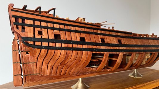

Brad - I re did this assembly probably a half dozen times on my build. Heres what worked for me. I added all the transom bars first and then fine tuned them for a flush fit with the fashion piece which was then installed.
If I had to build my ship again I would have completed both the bow assembly and stern assembly outside of the construction site on separate jigs. Maybe on the next build...

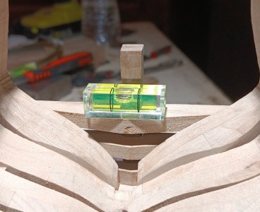

Spent the morning milling the three perpendiculars fashion pieces. I'm getting used to setting up jigs on the Sherline Mill. A very accurate angle finder had me mill all the interfaces at 12.2 degrees and from what I can see the interfaces are perfectly flush from every angle!!!

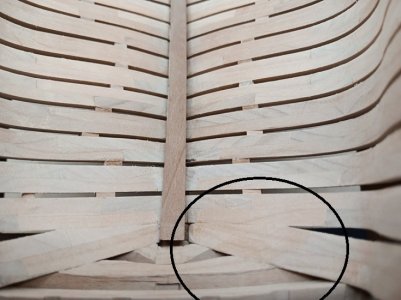

Help: Transom Counter Timber question????
Boudroit doesn't show the Stern counter timber/Wing Transom joint (red circles in below diagram). Should the counter timbers be recessed into the wing transom???

Others clearly show them fitting into recesses on the wing transom, which I think is the stronger and more accurate joint:
Any thought or feedback is appreciated.

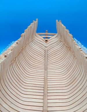

Completed and glued the Stern Cant Frames, Transoms, and Wing Transoms.
1. I added small 12-degree spacers at the top of each Cant Frame, for strength, then flush sawed them.
2. A view from the bow:
3. A view looking forward:

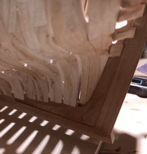

4. A view that shows the recesses for the Counter-Timbers, even though I can't find them on the Boudroit plan set. Thanks Chris, Olivier, and Paul for encouraging me to mill them!

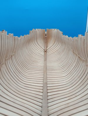

5. Finally, a view showing the 1st half of the hull, which is now completely faired. I placed the Keelson, to see what it will look like.

Nicely done Brad! Magic Mike

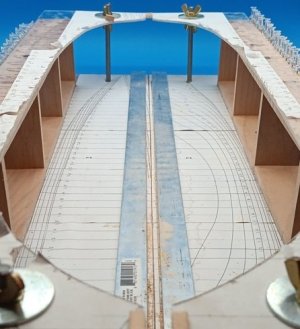

I was smiling when I took the picture of the empty building jig below:

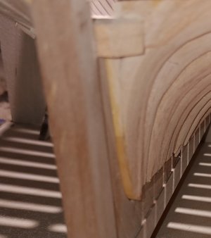

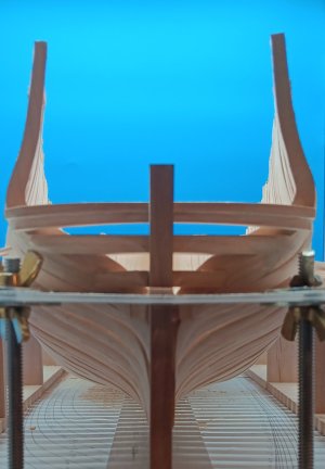

While placing the model in a new building cradle (NO, I didn't drop her), I felt something weird by the stern post at the keel. Here is what I found:

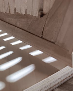

1. The pearwood on the port side had a tiny crack in the deadwood (easily fixed).

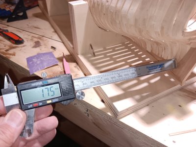

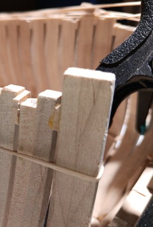

2. Just above the crack is the error that has me devastated. Somehow the piece that support the aft Cant frames shifted during the final glue up. See additional photos below:
It shifted 1.75mm :mad: :(:mad:
So how to proceed? While I drown my disappointment is my best Single Malt, here is the plan:

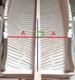

First, I checked several things.

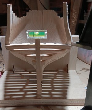

1. The Cant frame is still perpendicular to the keel.
2. The transoms and wing transom are all perfectly level.
3. The distance A on both sides is less than 1mm of each other.

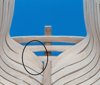

The plan:
1. I will fully plank and detail the port side. This will cover up the cracked pear in the deadwood. I will then be able to add some wood into the gap and fair it for planking.
2. On the starboard side, leave it Navy Board/Admiralty style, with cutouts to show the internal details.

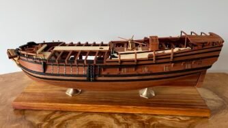

Similar to the build by Alexandru Gurau

I'm no expert but know the pain of discovering something unwanted. I'm having a hard time imagining that there aren't other spin-off problems created. You addressed a possible solution for the exterior - what is your plan for the interior? How much of that will be visible or are you going to end up building out platforms and rooms?
As always, your intuition out-trumps my "wishful thinking" last night. Laying the keelson on the centerline makes the unequal fairing/curves immediately jump out.
This wasn't so obvious, w/o the keel set on centerline, as it's only around 1mm.
