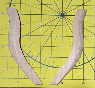

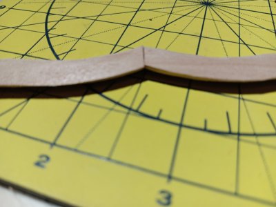

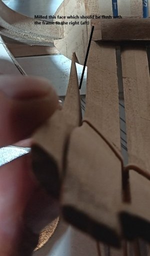

On my first attempt at the bow cant frames,
I believe I milled angle on the wrong face.
See photos below and please let me know if you agree with my assessment:
1. I should not have milled the angle on the aft face of the frame.
2. I should have milled the angle on the bow face of the frame.

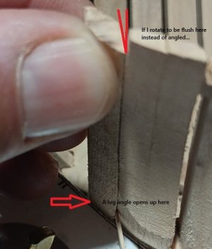

Hi Brad,
If you hawse timbers are constructed the same way as mine on Fame - only the side of the timbers facing the next timber is beveled. The frame facing the stem is always flat. Hope this helps - believe me I may have built these a dozen times before getting an acceptable result.

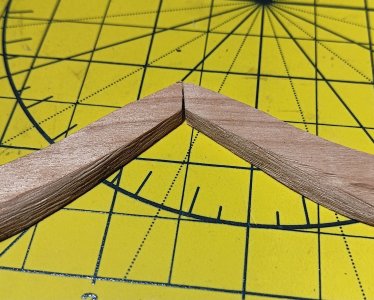

Thanks!
Exactly how I did my second attempt. It was also my first "official use" of the new Sherline Mill.

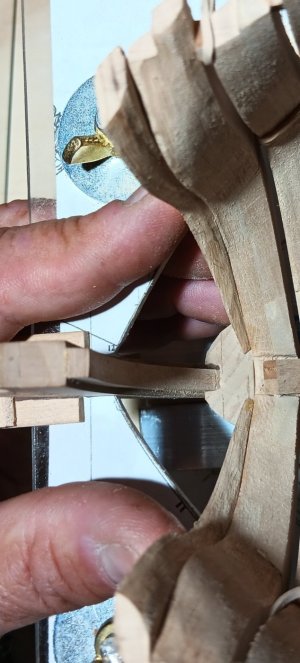

Here are the results of what looks to be the first successful set of cant frames.
1. Symmetrical from all angles and the Sherline produced a great surface.
2. Flat (unmilled) edge sits flush against the last parallel frame. The beveled edge faces forward, and the next cant frame should sit flush against this edge.
