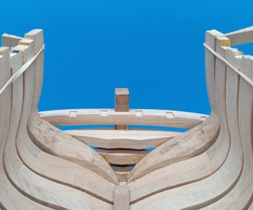

Four hours: the stern transoms and skewed stern frame are GONE!
I'm feeling better!!!

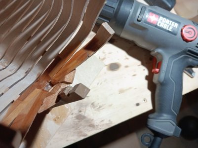

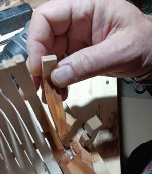

I cut through the transom pieces and brushed each joint with water, until I felt them loosen. Then a few seconds with the heat gun and they slipped apart. See photos below:
Here are the shots I was trying to get when I discovered the frame I somehow skewed.
Now she sits in a new building jig, with the offending frame dry-fit.

Thanks everyone for encouraging me to tear apart the stern and "Get it Right"!! Not as hard as I anticipated.
View attachment 563767 View attachment 563766

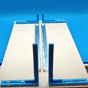

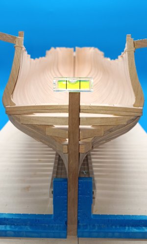

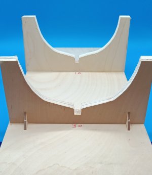

4-hour to Demolition the stern. 4-days to Rebuild it AND construct two types of cradles.
The cradles may be interesting to new modelers, looking for ways to secure their hulls during construction.

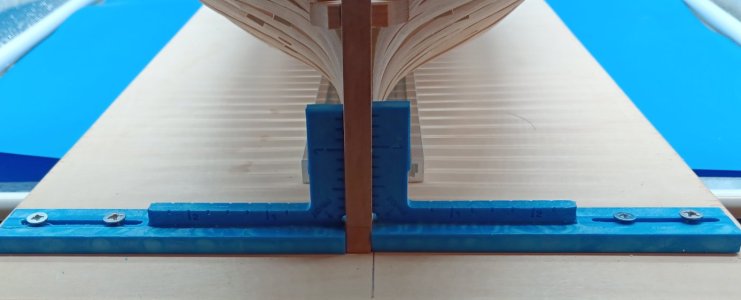

The first cradle is simple. Cutout two profiles (frames 10 and 30 in this case). It allows the hull to be set down and picked up easily.

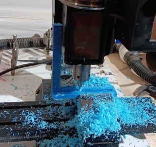

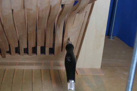

The second is made to hold the hull perfectly level and perpendicular. To build it, I bought 4 plastic rafter squares for $7 each at Home Depot. Aluminum were $15 each.
I then made some blue shavings with the mill! (I'll be finding blue shavings in the workshop for the next month) :D !
Combined with two strips of aluminum channel and Presto: an easy to secure jig for accurate and repeatable measurements. A half turn on the screws and they slide easily, releasing the model.

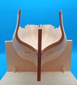

Pictures of the repaired transom frames, with the ship in the new jig to ensure everything is square and level. Amazon also delivered a 1/16" end mill. This small diameter made squaring the grooves for the counter timbers much easier.

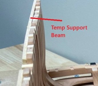

Next, I'll review a bunch of build logs and try to figure out what the next step should be. I feel I need some more longitudinal support before sanding and fairing the exterior. My thoughts:

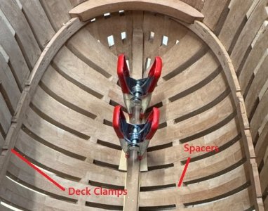

1. Add the deck clamps and spacers, as shown on Oliviers Rochefort. I forgot to put in the spacers as I installed each frame :mad:.
2. Add a top longitudinal strip, like Chris Bren did on his Renommee.
Thanks for your continued interest as I work through the build (rebuild) sequence!!

Add the strips long the top of the frames as I have done and also the spacers between the frames or "keys" as they are called are a great ideas. La Renommee according to Boudriot did not have keys but there is some debate as it was current practice for the times and some modelers have added them.
Installing the deck clamps is also a great idea.

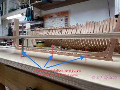

Hi Brad, you've made great progress. As I've read, you've solved all the difficulties very well. I can only agree with Chris: leave your hull in the jig as long as possible. If possible, screw the keel to the bottom plate. I think Chris had a slight warping of about 1mm there. I had the same issue with my La Palme; I screwed the Le Rochefort keel in place and there was zero warping.
View attachment 564693View attachment 564694
Chris/Tobias, I too am worried about warping.

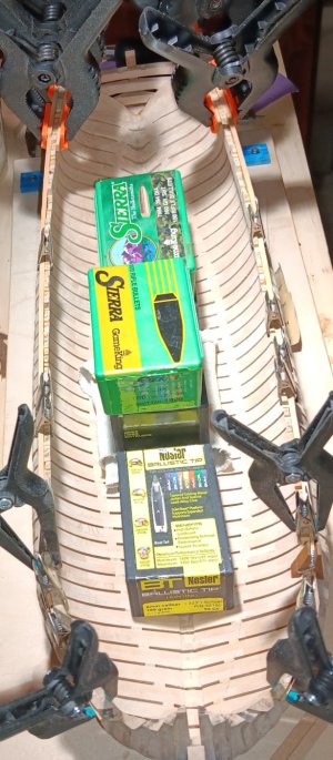

The construction jig I made has solid 1/4" aluminum rails screwed into the wood, to prevent warping L/R along the keel.
I also place heavy weights along the keel to prevent any hogging of the keel. I am also worried about twisting, higher up, so that's why I want to get the longitudinal beams in as soon as I can...also to give support for sanding the exterior.
I hope these precautions will prevent any warping.

No build updates because I'm on my 3rd redo of the stern cant frames :mad:! This attempt may pass inspection....

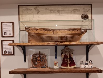

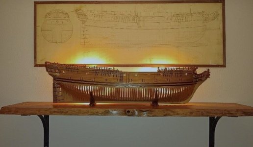

So, I'll share my Admirals addition to my model shelf for the holidays.
Wishing everyone a wonderful day, as we celebrate one of history's special miracles!!
Love the drawing behind the model. I wonder if tis would be a nice thing to have attached to the back panel of the case itself?? Would like to know if anyone has done this. If it works, it would be a really nice finishing touch to the display.
Allan,
I thought about that. Three reasons I didn't:
1. I wanted to backlight it, with some flush wall mounted lights, so the framing popped (see photo).
2. I like having the body plan there too so people can understand how each frame was drawn.
3. When I had it directly behind, you really couldn't see the plans, just a bit of the bow and stern.

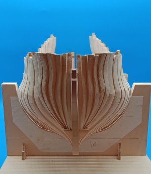

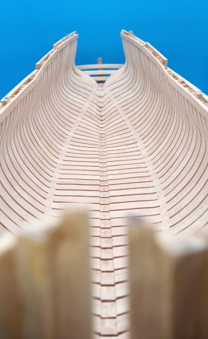

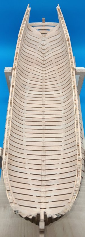

3rd redo of the Stern Cant frames completed!!!!:cool:
Turn of the bilge frame spacers were also added.

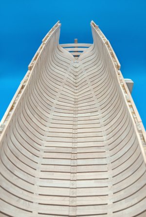

The entire interior is faired and sanded.
Will oil the interior this weekend.
Longitudinal stiffeners at the top of the frames were added, both inboard and outboard. She is very solid now, so sanding the outside can begin soon. 5lbs of copper bullets keep the keel from hogging Beer !
