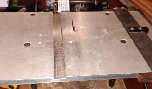

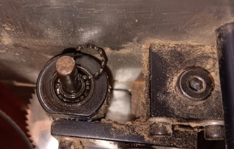

Catastrophic failure in the mobile shipyard. Bearings in the 40-year-old Preac table saw finally gave out!:oops:!o_O!!!
This dependable tool produced lots of sawdust making timbers, carlings, frames, deck and hull planks, etc.
I've got a Proxxon in the Amazon Cart and a call into Byrnes to see if they are selling their table saw. If I don't hear from Byrnes on Monday, I'll push the Amazon button and live with the Proxxon.

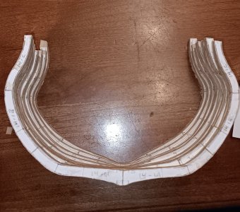

Workers did manage to complete 7 frames for the Salamandre:

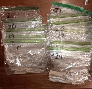

Without the saw, workers are lofting frames to paper and staging them in plastic bags.

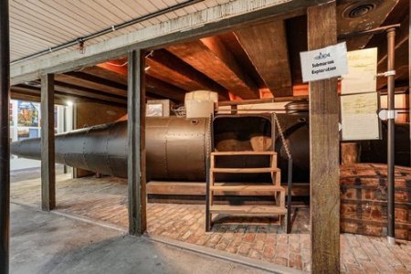

We did visit the Louisiana Maritime Museum in Mandeville on the North Shore of Lake Ponchatrain. Some interesting exhibits, including a full-scale Confederate Submarine "Pioneer":

Sorry for the passing of your Preac saw. Are you able to replace the bearings or is this a good excuse for upgrading? Fingers crossed for the Brynes!
Grainger may well have bearings that would work. Worth checking out. I see no harm in buying a new saw to lift your spirits while getting the old saw back in working order.

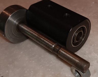

Olivier/Namabiru,
I've asked a bearing supplier for a quote on replacement bearings (Grainger did not have them). My guess is they are not cheap. Unfortunately, after further disassembly, I found the failed bearing had gouged the shaft beyond repair...see photo below. I will keep my eye out for a Preac for sale and use parts if one comes up cheap.

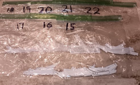

Last 4 nights were spent hiking, biking and lofting frames from paper to wood, on Falls Lake, North Carolina, near Wake Forest!
13 pieces/bag, for 28 frames. (photo 2).

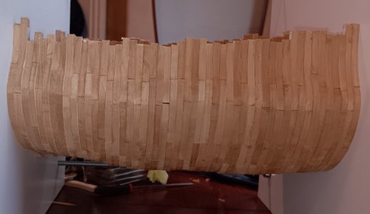

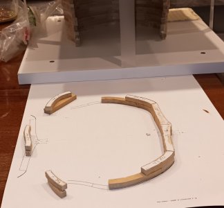

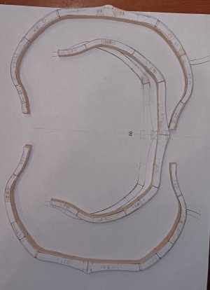

Next, the exacting task of glueing each frame up, over copies off the framing plan, 7-16 complete! (photo 3).

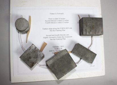

Do you add any weights to the frames while the glue cures so they do not move/lift? I do this for the initial gluing and again when the chocks are glued in place if the frames are chocked. Same idea if I go with double frames in place of single chocked frames.
Alan,
Absolutely. Each time I glue a small section to a frame, I use dense metal weights similar to the ones in your photo.

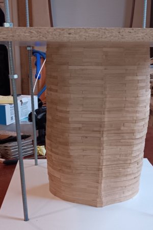

Once a frame is complete, I place a square of melamine board (photo), with weights on it, overnight.
Is the glue still not set at this point? Your idea of a board sounds really good and got me to thinking. Better than using the scrap spacer pieces like in my photo, which is to keep the weights from tipping, a clear board like plexiglass across the assembled frame could work. It is clear and if anything moves in the process, it can be seen and fixed before the glue dries.

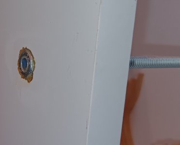

The jig below is how the shipyard keeps frames square and protected, while moving locations. Bolts on top keep things square. The bolts below hold the melamine board up while new frames are added.
Below picture show how the all-thread/nuts were countersunk & glued, in the bottom board, so it can be placed vertically.
