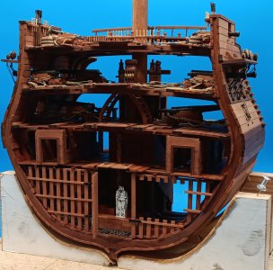

The iron ingots were offloaded to be used for forging and new cargo in barrels has been loaded for the trip back home.

The team that found her, estimated: "the ballast consisted of 40 tons each of pig iron bars, stone, gravel and French shot."
I believe the iron ingots would be deepest in the hold, along the keel. The looser/smaller stone/gravel/shot would then cover this "permanent and heavy" layer, providing a somewhat more flexible layer for barrels and cargo to nest in.
I've never seen any BHR models (including a museum quality scratch build on the NRG forum) show the ingots but to be totally accurate, they should.
My goal in the build is to make a reasonably accurate "battle-mate" to go beside my scratch build of HMS Serapis. Secondary goal is to get friends and family to ask questions. To that end, I included some ballast, placed tools at the cannon stations, rigged the cannons three different ways, and plan to set her on a "building/launching" ways.

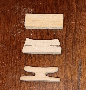

Small project, as the shipyard is awaiting barrel parts.
Workers fashioned two custom cleats for the main mast, as none were included in the kit.

I used a slightly different method. 50/50 wood glue/water in a small cup. Then I added the ballast and stirred it well, so all the stones were soaked with glue. The consistency was like thick, crunchy, oatmeal.
I spooned and shoved this mix into the bottom of the hold, then laid the barrels and crates on top, while it was wet. It sat overnight and all seems very sturdy and well glued together.

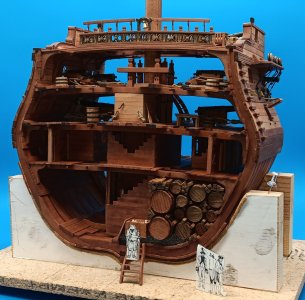

Ski vacation is over, and the Shipyard moved back to the basement.
Barrels were finally banded. Petty Officer Brutis then loaded them, with lumber for the ships carpenter, used as bracing.

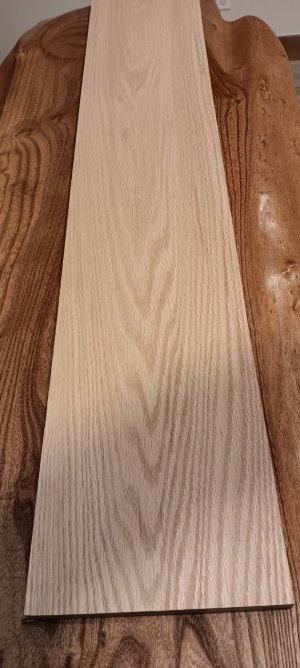

Shipyard is waiting for a 5-sided case that was recently ordered. A nice piece of red oak was selected to make the display base.
Ensign Newbie used Carlos's excellent plans for the launching way (see link). He cut and laid out the dunnage and it looks great.
Now we wait for the postman to bring the plexiglass case and the final steps can be completed.
