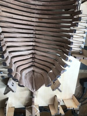

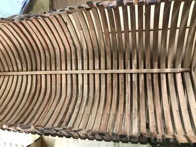

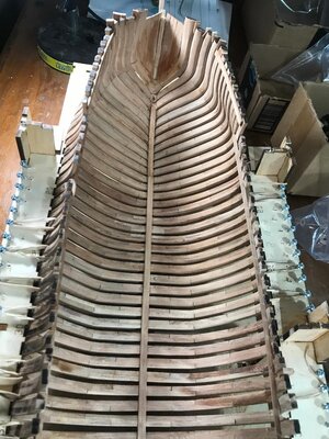

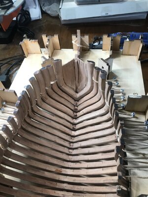

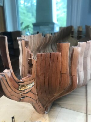

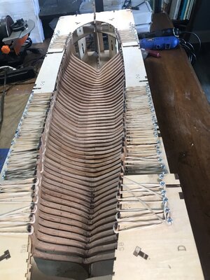

Frame by frame she is taking shape Paul

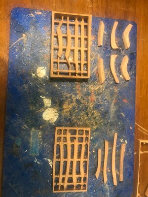

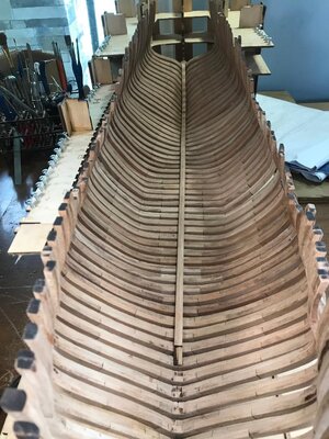

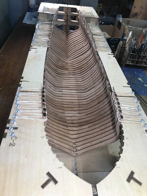

Maarten thanks for the advice, I agree on the dust bucket!! When you say ceiling, what exactly do you mean?Hi Paul she is coming along nicely.
You can fit the ceiling first, then she will be ridged enouch to remove here from the jig to sand the outside frames.
If you first install the interior before sanding the frames your whole interior will be one big dust bucket.
Hi Paul, the ceiling is the inner planking in the hull, this gives your hull already an enormous strenght.Maarten thanks for the advice, I agree on the dust bucket!! When you say ceiling, what exactly do you mean?
Ahh...got ya! That I believe is the next step, once I finish framing, and do final interior beveling. I will be ordering the Internal structure from CAF this week, which includes the ceiling lumber. Thanks!Hi Paul, the ceiling is the inner planking in the hull, this gives your hull already an enormous strenght.

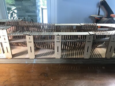

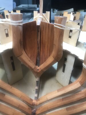

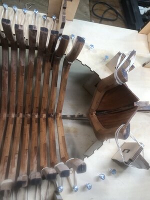

Thanks for the Likes!not much done today.....other things on the "honey do list"....Still fine tune sanding hawse timbers, and added frame 5. Only frames -3-4 to go on the bow.
Wow, thanks Bill! Much appreciated!!Paul, Your photo documentation of this build is superb. Definitely a build log many will seek out when doing their own builds of this magnificent ship!
