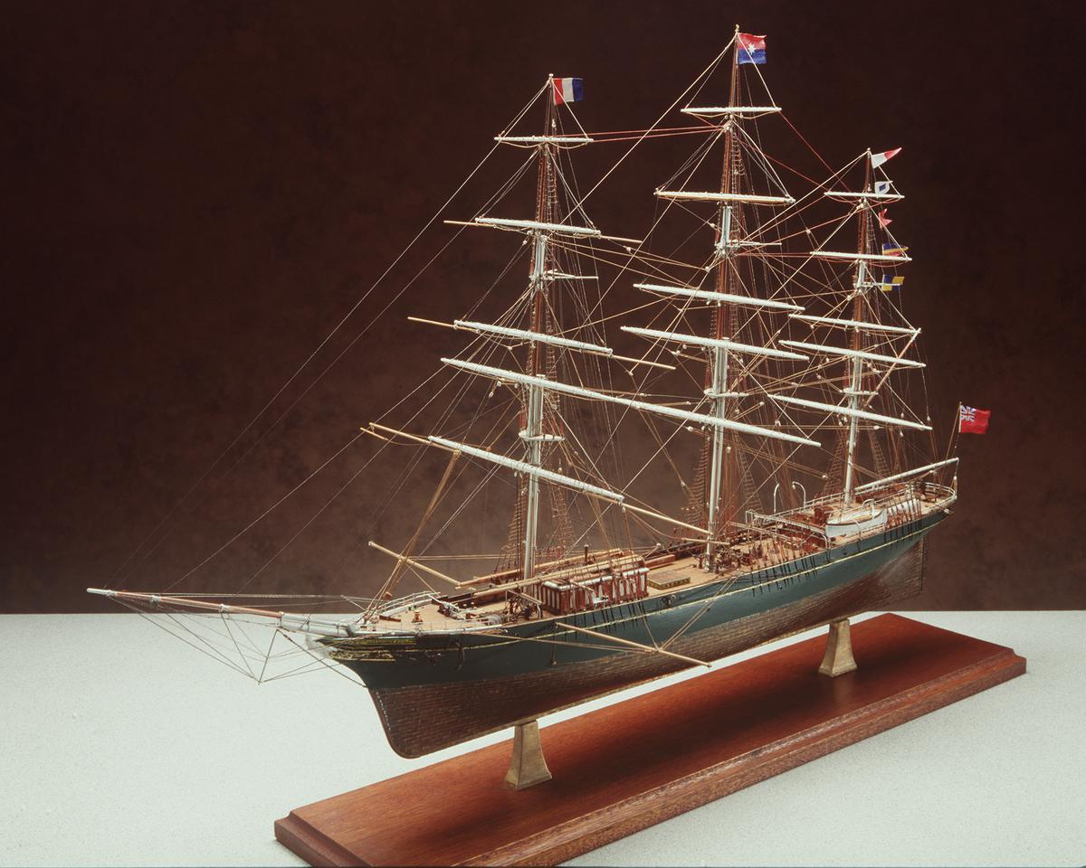

Cutty Sark Semi Kit 1/40 Prototype
I have started to cut the detail parts today.
Deckhouse carcasses cut and assembled, in 30 mins.
The Main Stay lugs are in but not glued.
The knightheads are machined, note slot on back for Forestay lugs which get pinned through the knightheads.
The knightheads have a few complex bevels to be shaped and it's made of 2 parts like the real thing, in the ship the fore and aft halves are sandwiched either side of the keel plate which extends up the back of the apron and upwards, another big fault with kits is the knightheads are shown in line with bow or rabbet, they are not, they are aft.
Here the plate can be seen on the back of the apron and the parts go either side. note the forestay lugs
Here the Forward side of the knightheads is in place and the plate is seen with the aft side removed exposing the lugs.
The bent over flange on the plate does not go all the way up and can be seen down just above the foam where you can see the pin heads seen in other shots.
In the interest of showing the placement in relation to the stem for other modellers here is a good profile, again the forward side is on but not the back.
