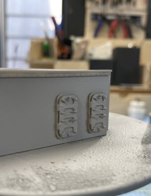

So here was, happily designing the first deck house. Main shape: tick. Riveted strip along the top: tick. Rivets over the side plating: tick. Welds over the horizontals: tick. All in logical sizes for 1/72 scale. Happily calculating a half inch rivet head to 0.08 mm, with a nice chamfer of 0.07 mm.
Wait …WHAT?
And of course I wanted to try the new software AND wanted to print stuff in resin that should be printed with filament.
What could go wrong?
ROTF
Everything.
Rivets et al invisible, flat panels wonky, half of the other detail smudged and bubbly.
Back to basics, old boy.
- print the main structure in fdm (nozzle pumping out filament goo)
- print the nice details in resin (and exaggerate the rivets, 0.08 mm what was thinking?)
- assemble
Oh well. I’ll grow up one day and stop taking shortcuts knowing beforehand they’ll just go pear shaped.

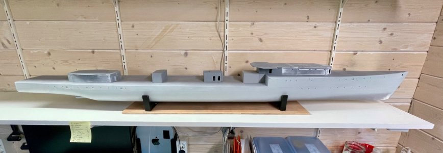

This is the phase of chunky main parts, like deckhouses. And as they come off the filament printer, there’s a lot of filling and sanding to be done. Even at high quality, you can see the small printing ridges. Simple to solve, but rather a chore.
Oh well. It starts to look like a ship.
Turned out my fdm printer required calibration: strange ridges on the sides of the main deckhouses. So lost some time on the printer, as the one thing always turns up another. But it works to par again.
Designed and printed the last deckhouses and did some filling and sanding on the ridged ones.
With all the dust had to wait another day before I got to a next primer coating. Which of course ended in a small disaster: the hull turned over the wet primer. Oh well, more sanding and priming.
It’s just a huge lump in my work shed, so I keep on bumping into it. But I’m nearly at the stage I can do the final coating. Grey top, black band, red bottom. About 5 yards of tape …

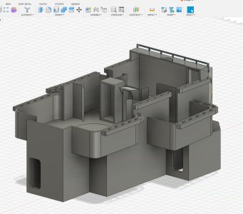

Looking at the drawings and lots of images of a typical destroyer bridge, I designed this to my best capabilities. Feel free to point out mistakes.
It looks the part in Fusion, but I will let it rest overnight as I'm sure I made a few slips. It will be close to what I want and what it should be.
The hard part will be the printing, with all those nooks and crannies. For that reason I made some parts thicker than "to scale", as I have some experience with too thin walls: 0.7mm is doable. I hope. And I will have to think about how to position it on the print bed. Best would be so it can easily drain superfluous resin. On the other hand I don't want all kinds of little nibs of supports. Oh well. we'll see.
Once this is printed, I will add all kinds of details like floor planking, cables, curtains and whatnot.
Fun!
