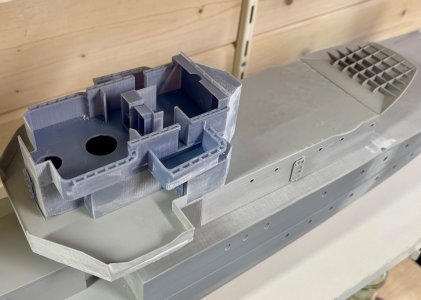

After having to stay out of my work shed for three weeks, I finally am of drops and eyes start to be back on track (if not already better than the old ones :cool:).I started the resin printer on the deckhouses and some of it goes well, some of it not so. It is always a bit of a hassle to find the correct angle and positioning on the print bed. But I am getting there. You see the rear of the bridge deckhouse in my hand. Lots of angles and some really thin plating.

Your deckhouse is thin indeed; see-through plastic. Very precise printing, by the looks of it.

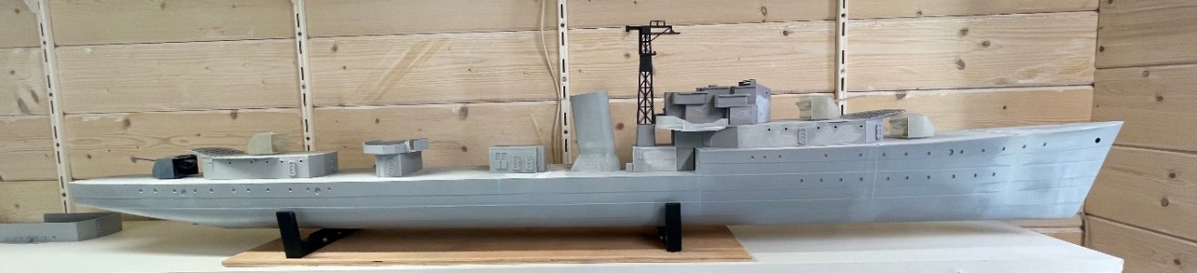

She starts to look like a destroyer … about time to start sanding, repairing (not a lot to do), prime coating and bonding parts to the deck.
So I’m back where I was a couple of months ago. But really happy I made that decision to start over.
Have a good Easter weekend.

That is looking great, Marco. With a nice lattice mast.
