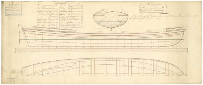

Does anyone knows how / where I can find lines plans for the construction of the ship boats ? pinnace, cutter, launch
What country? If England there are dozens of drawings on the RMG Collections site as well as on the Wiki Commons site. There are scantling for every part in Scantlings of Royal Navy Ships pages 256-259 for a variety of types and sizes of ships' boats which are from Steel's The Elements and Practice of Naval Architecture .
One example of a pinnace from the Wiki site in high resolution is below. Note the pinnace is usually single banked. This drawing shows the tholes on the starboard side on the profile view and the tholes alternating on the port side on the plan view as was typical for pinnaces.
