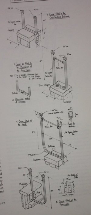

Most contemporary models do not show the hammock cranes so you would be in good company if you leave them off. They were definitely used for a long time on the actual ships. If you trust the information in Goodwin's book The Construction and Fitting of the English Man of War page 211 the following may give some help.
Hammock Cranes
These first appeared around 1710, and were mainly fitted on smaller ships such as frigates and sloops. Their use being limited to the quarterdeck and forecastle. The stanchions, made from wrought iron, took the form of U-shaped brackets with a single spike at the base, set down into the planksheer. These cranes were then covered with a tarred canvas screen. An example of the form can be seen on the model of a 60 gun ship hull in the Establishment of 1710 in the Science Museum in South Kensington.
Over the next 30 years the employment of hammock cranes became fashionable, and they were used extensively on upper decks, including the poop decks of the larger vessels. Finally in 1746 the Navy Board recognized the advantages of this practice, and submitted a letter of authorization to the Admiralty on 26 September stating that they were to be fitted on all ships. Within ten years this arrangement had become universal throughout the Fleet.
By 1771 the design was altered becoming more square in shape with an additional tie bar set between the heads at each upright. This type can be see on board the Victory. This form is illustrated in Figures 8/7 2 and 3. (See below). Another alteration was the introduction of netting suspended between the inner and out stanchions. This proved more practical. The netting used had 4" to 6" holes. Canvas covers were still used but t was found that during hot weather the tar stained the hammocks. This was eliminated by a Navy Board order of 1780, that the covering clothes were to be painted either white or yellow.

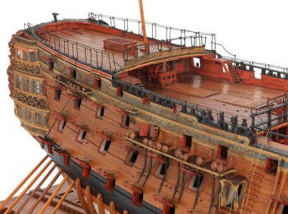

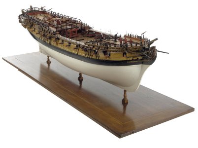

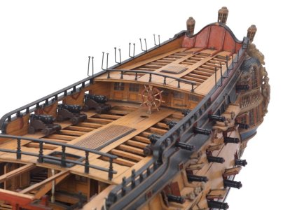

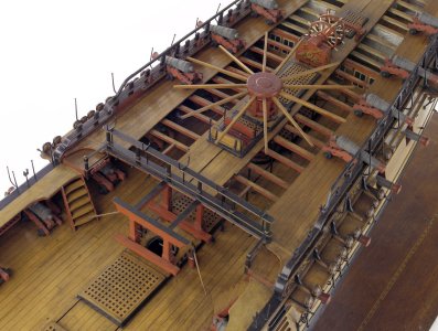

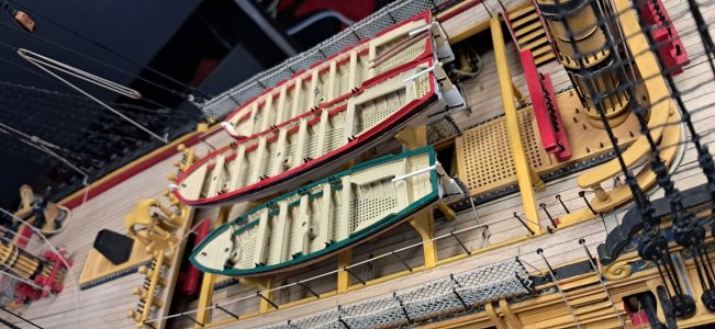

What are the ships/years in the photos in post #126 above?
So are you saying every ship (all cases) had cranes and nets and that some of the information regarding when they came into use as researched by Goodwin is wrong?
All the ships are British, and all are from the period we need. All the models are original and are kept in the Greenwich collection. I never show pictures that are not relevant to the subject at hand.

What is the name of the second ship ? (first picture seems to be hms Victory in his orginal shape) Very beautyfull hull. This give me ideas for a future project :).

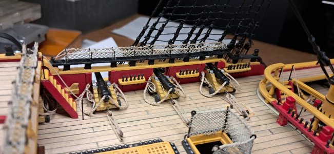

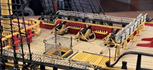

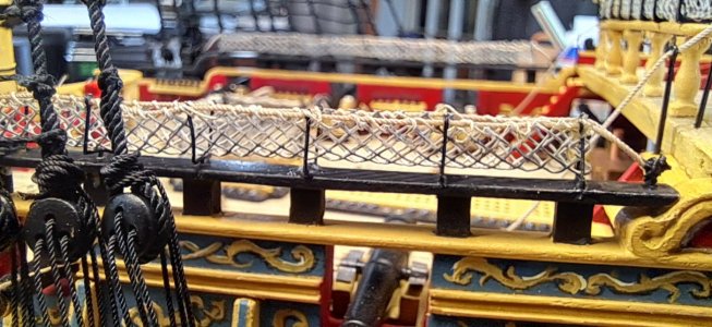

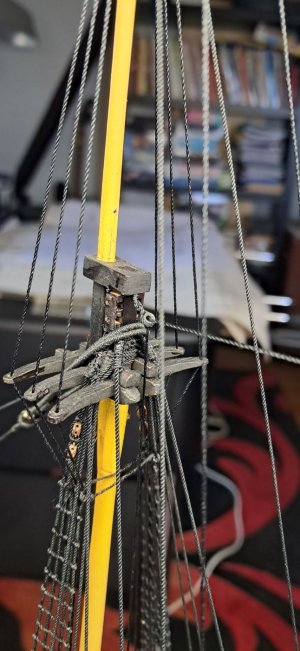

I started yesterday with the nets on quarter deck. Very difficult to realize because the presence of schrouds, small and fragile cranes but I'm rather proud of the result. Cranes are 6 mm high.
Iutar, I adapted the color of the lanyards to black, but don't be upset to me if I keep the nets brown/natural because aesthetically it gives a much nicer effect than black, ;).
Yes, this is the very same Victory model, created under the meticulous supervision of Sir Thomas Slade himself! This model is a benchmark! The second frigate is also famous, a hero of the war against the Americans, the frigate Amazon. This model is built according to all Admiralty regulations, and its hammock nets are worthy of respect.
Pictured below, this model is considered a unique work of art and has historical value because it was made in the workshop of Sir Thomas Slade himself, under his supervision. I wish you, dear William, a pleasant contemplation of such a beautiful and perfect model. It's simply magical!
