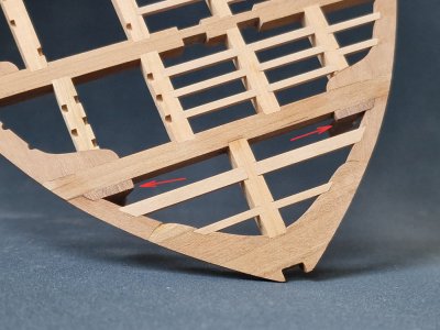

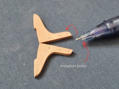

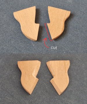

Rudder. First hull.
When I started the project, I thought the focus would be on the second hull, and the first (since it's from a kit) would serve as a base for the second. But as I worked, I realized the kit hull was turning out quite well (frames, deck parts, it's a shame I didn't completely redesign the keel, including the stem, initially).
So, while making new rudder hinges (using electroplating), I realized I couldn't use the kit hinges on the first hull. In terms of appearance and authenticity, it's a world of difference. So I decided to completely redesign the rudder and sternpost (again, I really regret that I can't redesign the entire keel, but I'm using the existing one).
This is still an intermediate stage (photo for clarity), and now how I reworked it. The method is simple: I simply copied the old parts as if for a conduit, milling the new part to their dimensions.
I have already made a similar kit for the second case, so I will not repeat the rest of the processes.
Well, here's a comparison. (The steering wheel and hinges aren't ready yet! There's still some fitting, sanding, and blackening to do, but for clarity, here's the result.)
In the photo above: on the left is a set for the 2nd case, in the center is for the first, on the right is from a set (it was for the first but was remade).

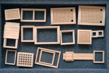

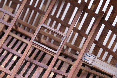

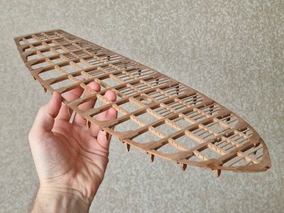

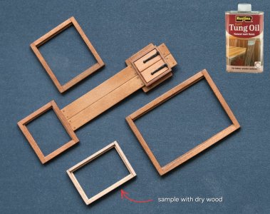

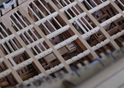

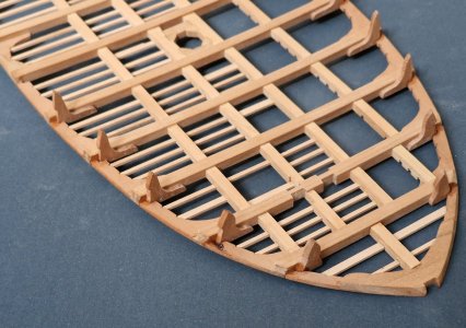

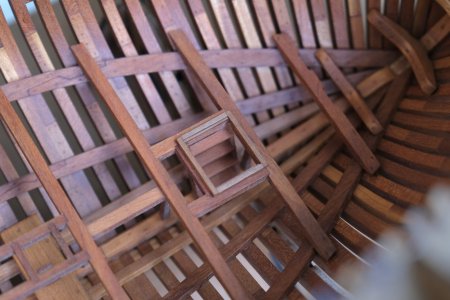

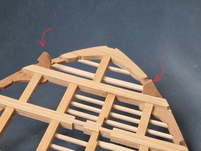

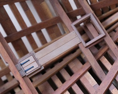

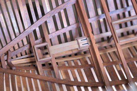

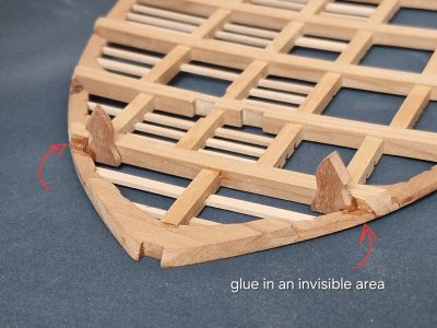

Chapter 20. Decks (1st hull).
Lower deck. Grating frames.
The entire lower deck will be as bare as possible, so that all the frame components are clearly visible. Therefore, there will be no gratings in the frames. There will also be no planks, with the exception of two between the two rear frames.
Making such simple parts isn't difficult, but here's a step-by-step process.

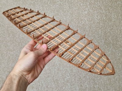

Below are all the frames for the two models, but some will soon be glued to one of them...
But before that, the parts will be coated with Tung oil.
To create color contrast, I'll alternate between Tung and Danish oils to prevent the pieces from blending into a single blob.
The final fitting will be done, and the pieces will dry for several weeks before I glue them to the deck.

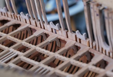

Before I secure the upper deck, I really want to shoot a video with a good camera and show the lower deck's structure and the inner frames in detail. Even though I didn't glue all the bulkheads in place, visibility is still, to put it mildly, poor enough to see everything clearly.

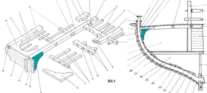

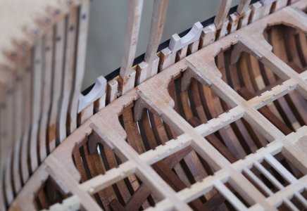

Knees.
I made it so the deck could still be removed even after the knees were installed. Since they are secured over the boards, I have just enough clearance to keep the knees out of the way.

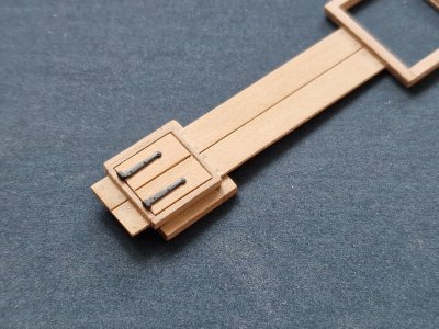

Next up are the window sills, a tedious process of fitting them into place. But this is the most challenging part, and I spent weeks pondering how to implement it. Especially considering that it will be different on the two models.
Knees.
