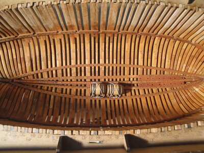

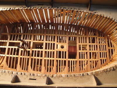

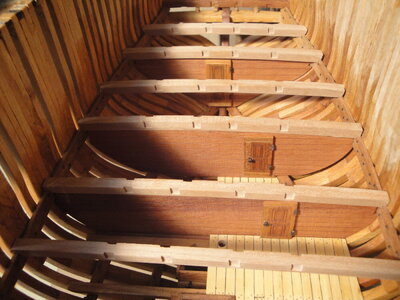

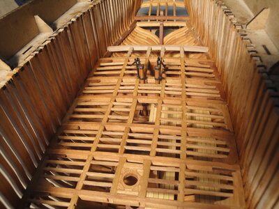

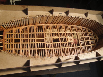

Hallo everybody. Shit happens. It was only a matter of time, everything went too smooth till now. When fitting the first beams of the upper deck I was shocked. There was a 15mm shift between the lower and the upper beams (look at the pictures above). This way nothing will fit; the mast, the kitchen, the cabins, will be all out of place in relation to the upper deck. I found no easy way to correct it, so I had to dismantle everything inside the ship including the thick stuff for the lower deck which will have to be moved 15mm in the stern direction. Almost everything will have to be adjusted. That is the prize one has to pay if you don't think twice, three times before installing something.

Thanks god, that you were avle to remove the parts without bigger damages - I guess you are working with waterbased wood glue?
Hinterher ist man immer schlauer.
A good modeler is accepting his own mistakes - you should not make the same twice
Very good decision to remove and restart
Hi Peter,
Sorry to see all this work was for nothing. What went wrong? If I remind correctly there is a template in the kit to properly position the shelfclamps. I also saw that after I fitted them :-) but I used the deck beam positions towards the frame positions to allign them, sofar that worked fine.
Thumbs up for you to make this demolition step it only will make it an even better model.
And psst, we have all been in such a situation through out our modeling years.

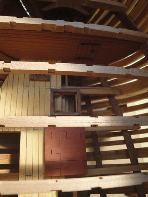

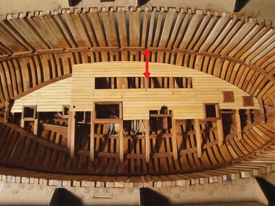

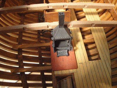

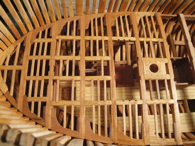

Hallo everybody. Thanks a lot for Your kind sympathy. Your opinions confirm my decision to rebuild the ship interior. Thanks god the mistake was easier repaired than I thought although there was a lot of fitting and reconstructing of some parts. Now the deck beams are positioned directly under each other as it should be (see the red arrow on the picture).

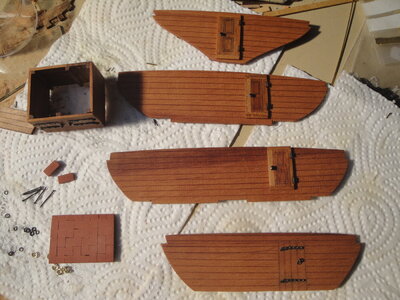

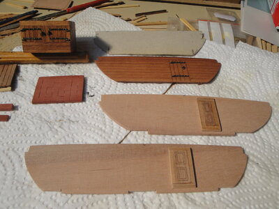

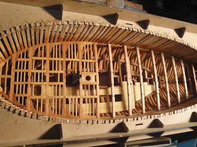

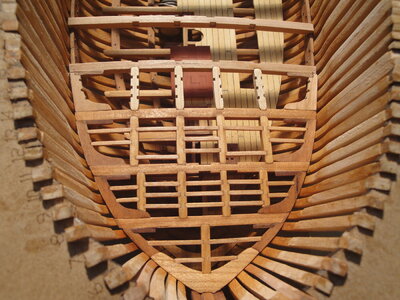

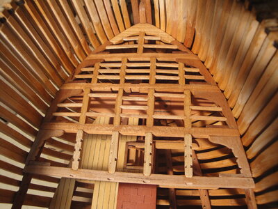

Hallo everybody, thanks for all the likes. As mentioned before, I had to decide what to do with the cabin walls. Either skip the walls or construct new ones. I have chosen an interim solution and build only the bulkheads. I used the card board templates and transfered the shapes onto the 2mm swiss pear board. I cut the grooves into the boards imitating the individual planking. I also constructed further elements of the lower deck such as sailroom and the brick base of the stove.
The next step will be the stove and than I can move to the main deck.

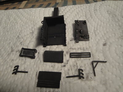

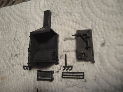

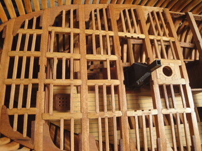

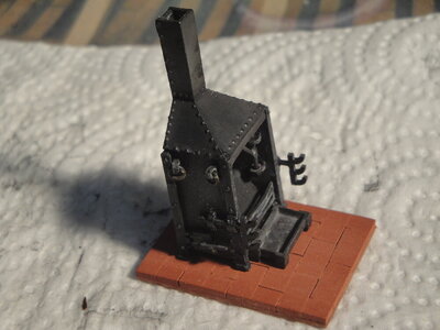

Hallo everybody, The next step is the stove. All the parts fit well together, only the holes had to be drilled. After mechanical cleaning the parts were degreased in acetone, than rinsed with water and finally treated with blackening agent (based on Selenium dioxide). After blackening (approx. 1-2min.) the stove components were again rinsed with water and dried. After drying all the parts were glued together with CA glue.
And that's it. Now I will start the construction of the main deck.

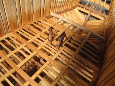

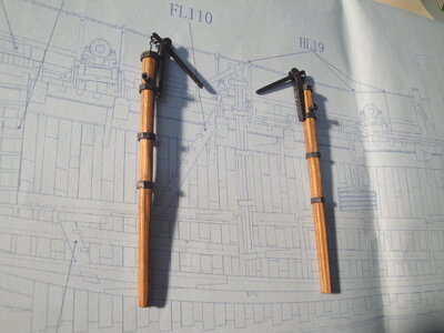

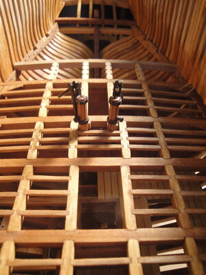

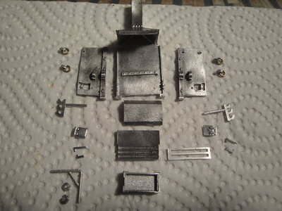

Hallo everybody. Jim and Uwe thanks for the kind comments and all the others for the likes. While continuing the construction of the main deck I had to check/adjust the position of the openings for the water pumps. To do this, I needed the pumps, so I put them together after the long search of the wooden parts. The metal parts were no problem but the wooden ones were not in the manual's part list. Finally I found the pieces in the kit box on the separate board nr. 26.
After small corrections the pumps fit perfectly and can be removed now . They will be placed in their final positon later on.

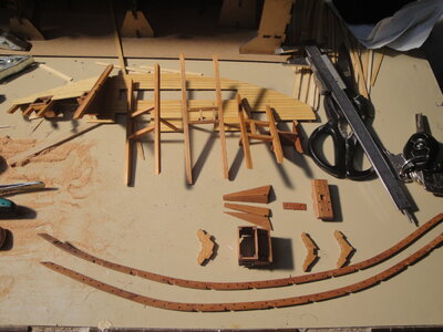

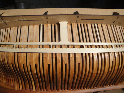

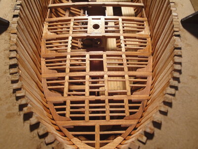

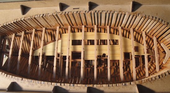

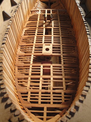

Hallo everybody. Thanks for all the comments and likes. The construction of the upper deck structure is finished.
To prepare the "big cut" the templates provided by Trident Model are very useful and make the job much easier.

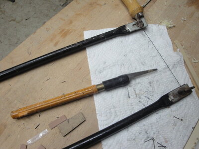

And now, the big moment: the first frames were cut within the hull structure to the proper length according to the template markings. I used two different saws, depending on the width of the slot between the single frames.
The overall structure is still stable, no frames break out till now, we will see how long.
