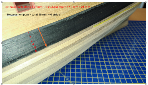

Today I had to notice something strange again: a contradiction in the instructions versus plans.
According to the instruction booklet you first need to glue the Black strike (0.5 x 1mm) and then another 6 strips (1 x 3mm) which gives a total width of 21mm. But if you do this the last strip will be under the waterline!!!! On the plan the total width is only 18mm so you stay just above the waterline!
So instead 7 strips (21 mm) I only gleu 6 in order to stay above the waterline!!! Sick Sick Sick Sick Sick

The contract for the Diana gives slightly different dimensions for the wales than the kit. The contract dimensions are below. The breadth of the four strakes of the wales is 3' 9" (17.8 mm at 1:64). The single strake above the wales (the black strake) would be an additional 11 inches (4.36mm) broad and not as thick. Looking at the contemporary Diana plans, the bottom of the wales is 218 inches to the bottom of the keel at midships. (86.5mm at 1:64 scale). Does this compare with the kit drawings? The bottom of the wales is close to the loaded water line. Hopefully the following part of her original contract and the plans midships will be of some help.
