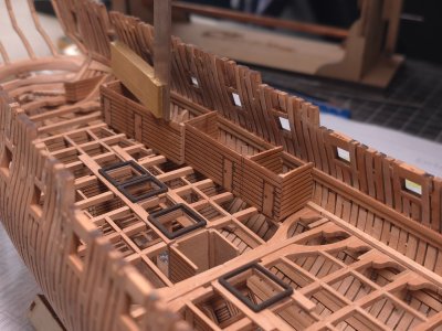

So I'm going to be using bloodwood to replace some of the fixtures and add some color. I've never actually worked with it before and it's proving to be difficult. It's a very dense wood that keeps turning a brownish red color. I've tried low and high grit sanding. Slow sanding and water sanding. It's a learning process.
But I think it's going to look great.

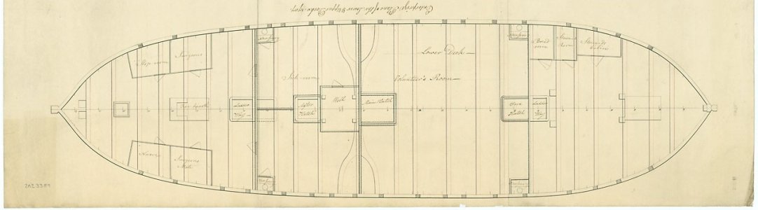

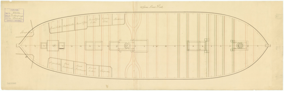

Going to the trouble of adding the cabins is well worth it, they look very good. Are your plans like the original ones below? There are differences in the two drawings from RMG as the first has 11 cabins as a fighting ship and second layout is with the cabins as a receiving hulk in her later life with only four cabins.
Thanks
Fighting ship layout (drawing covered the class from 1771-1778)
Receiving ship layout
Thanks
It's in the fighting ship layout. It'll have the two sets of cabins on both sides.

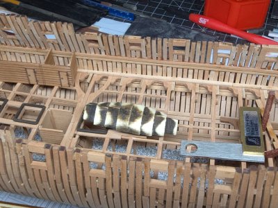

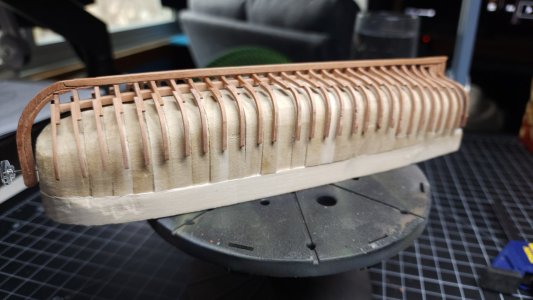

Took a small break to work on the ships boats. Designed and laser cut a proof of concept.
All done with 1/32 balsa. It's out of scale slightly, looks like it's just a bit too large so it'll get shrunk down. It's designed be built with 1 mm pearwood, so it's the balsa is a little thing and not everything fits perfectly but looks like it'll fit just right with the pearwood.

So I used the plates to make jigs so I could make them properly. They are so small, these are just for proof of concept, they aren't perfectly accurate because I just used 1/4" poplar.
Just for scale. I'll think out some boards so that the jigs are the correct size and maybe I'll finish building this deck finally
Using the laser instead of a scroll saw is novel. Nicely done! I have no experience with laser cutting but have a question. Even though you are using balsa, would it be easier to sand the final shape if you cut a plug piece for each station line rather than the thicker ones you have? Maybe the only advantage of having a plug piece for each station line is giving an exact location of every frame but probably not a big deal to mark the location on the ones you have. Just wonder what your thoughts are as you have obvious skills with the laser.
I considered that, but I think at this scale it'll be easier to transfer the locations of each frame. I used this method even with my 1/48 scale longboat that I've yet to finish as well

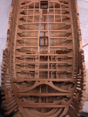

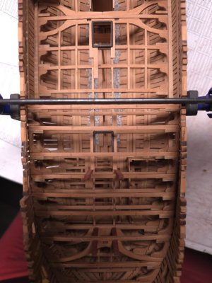

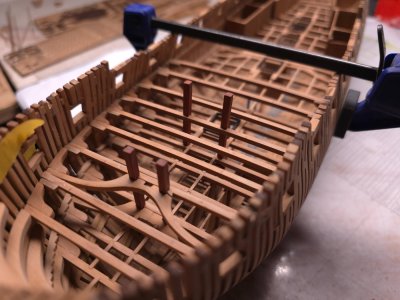

So either the shape/width of my bow is off, or the second deck is at the wrong height. I think my second deck may be a little too low. Or may it's all fine. The only issue is the first couple beams seem a little bit short.

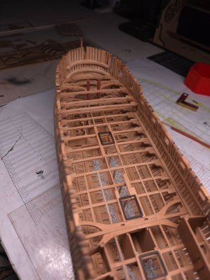

Figured out two issues. I forgot to clamp and pull the hull inward to get the beams to connect properly, so fixed that.

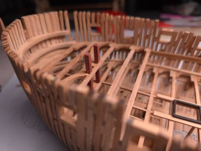

The other issue is for some reason my beams were crooked. Luckily I caught it after about 3 beams. Had to pull those out and cut down some of the knees to get things back on track. This deck doesn't seem to align perfectly with the deck below, so I'm going to have to keep adjusting.
Having never done POF before, I'll ask the newb question of how you came to realize your beams were crooked?
Best way to me is sighting the light between the beams raw under appropriate viewing angle. This kind of issue appears as pretty obvious in that case.
You are definitely going the extra mile to get things to your satisfaction and the beauty of your doing this is showing through. Well done!
