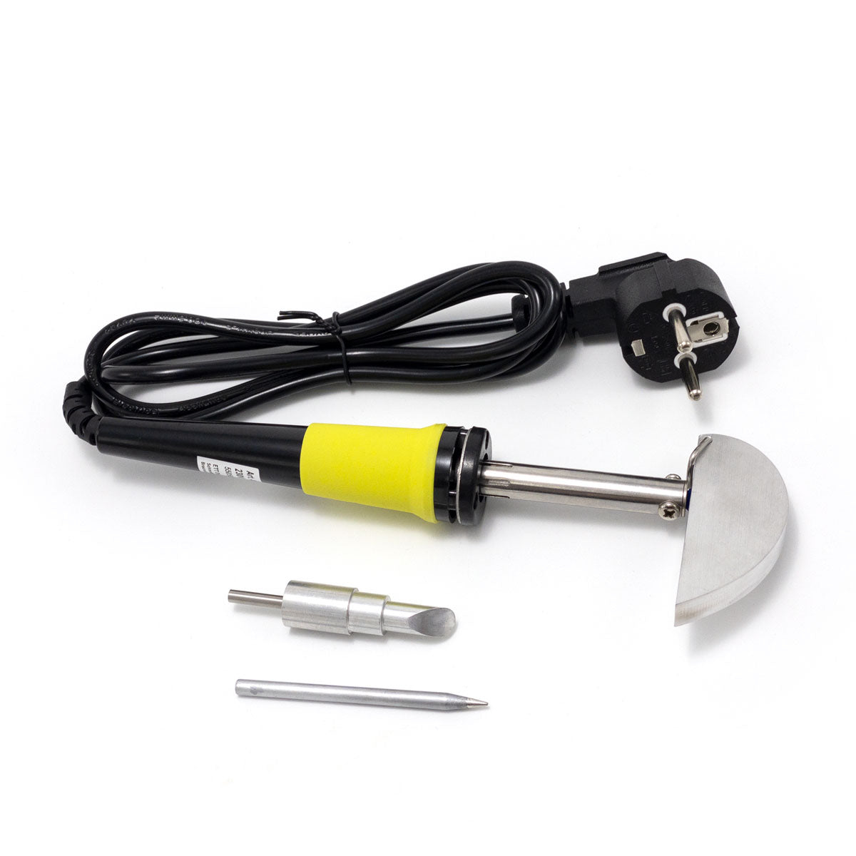

Hi Keef, you can use a soldering iron to aid in making bends. Or even sweeping the strakes along the edge of a hot iron. Or even a hot air gun (paint stripper).
Maybe something here to help?
Thanks Paul. l will try using a soldering iron Thumbsup
Soaking with water - I think I did not use hot water, but I am pretty sure that it would help a little bit
and the bending was done with a plank bender I purchased once from Kolderstock
But I used the tip which is shown on the right - here you get better the heat into the wood

I do all my plank bending by soaking and a womans curling iron. The clamping part really helps with bending.
Thanks for the info Daniel, sound like a good idea. My wife has quite short hair and l have very little so there is not much call for one of these in our household. l shall try what Paul (Dockattner) suggested and use my soldering iron. Cheers.
After marking the positions of the deck clamps, they then had to be fitted. The upper deck clamp consists of 3 parts of 2 mm thick precut timber which have to be shaped to fit the tight curves of the bow and stern sections. My solution to the bow section was to make a jig using some spare timber l had knocking around, which l cut to shape on my scroll saw using the drawing supplied as a guide. After soaking the pieces in cold water for about an hour, they became a bit more flexible and using a couple of clamps to hold them against the jig and with the aid of a soldering iron l was able to gradually bend the piece to the desired shape. For the stern section, as it required less of a curve, but had a twist, l just soaked the part and clamped it to the frame and left it overnight. It took the shape reasonably well after completely drying. It all fits spot on so very pleased with the outcome. l have my surgery scheduled for Tuesday but have to stay overnight at the hospital Monday night so not sure when l can next update. Thank you for your comments, likes and interest in my log. l very much appreciate it.
