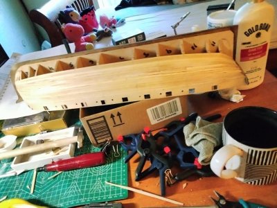

Planking coming along pretty good despite wild variances in thickness. This is mostly solved by clamping current and previous planks between the frames. Show in previous entry. Had my first tear out. This is my second attempt at First layer of double planking. Also did single layer planking on one side of the Bluenose. I could use some suggestions on what to use a a filler for low spots. The lightweight stuff I used last time didn't like acrylic paint.

Ted, I found a wood filler at my local Woodcrafft store and have have really good results with it. It stays really moist in its container, dries quickly and sands easily. And it takes acrylics well too. I found it just now on Amazon. (I think its a product from Australia)Screenshot_20250225-160943_Chrome.jpg
Ted, I found a wood filler at my local Woodcrafft store and have have really good results with it. It stays really moist in its container, dries quickly and sands easily. And it takes acrylics well too. I found it just now on Amazon. (I think its a product from Australia)View attachment 503410
I support what Phil says, great filler.
Here's the problem I m having. The next plank doesn't want to lie flat on the frame if put upright to the frame shown is the position where it lies flat.do I try to wrap the plank upward to continue current layout or so I add Steelers etc 17407710024223103191165548446954.jpg
Perhaps the toughest area to plank for a lot of modelers including myself is a short radius rounded bow. You might try using shorter planks say from the stem post to the 3rd or fourth bay, be sure to alternate lengths.
For the most part you cannot edge bend planks at the bow without them lifting. The best way is to spile the planks. A very close second, after they are tapered in width is to pre-shape around a form using water and/or heat. I have done this at room temperature, but it takes a few hours on a hot day so using a hot air gun reduces the time to a few minutes. You have probably seen these methods posted here at SoS including photos and videos. The best video that I have seen is probably Chuck Passaro's four part video or variations of his methods. If the plank is spiled or otherwise properly pre-formed, no nails or clamps are needed. Finger pressure for a minute or so with PVA, or even less time if you like CA glue, is all that is needed.
The photo below shows a wet plank that was bent to the curve needed and held flat with clamps. The heating was with a soldering iron, but I have since gone to a cheap industrial hot air gun from a local hardware store with is easier to control and is faster.
You can see in the below that the wood is nearly dry compared to the first photo. Once dry the clamps are removed and the plank will hold its shape.
I bend in the other axis is easy to do with a hot iron, plank bender, or jig and hot air gun.
I accomplish edge bending on a pin board after steaming the stock. (soaking in hot water works too)
I used to do that as well, but I would get little dents in the edge that were visible, even with Castello and other tight grained hardwood.
Is this ever a problem for you Phil?
Thanks
Thanks
Yep. But I plan for it and use a rotary drum on a Dremel to sand the edges down to my marks. Because I steam my planks, they bend easily though....

Here's the status of my hull. 1mm plus variance in the planking thickness and width. Thank along with my confusion on how the planks die off into the deadwood have slowed e down. I'll just try to make it look right. None of the profile plans show any planking or copper plates.17413590531104468085722280135453.jpg
In the beginning of planking I cut up two planks to verify the number of planking rows it would actually take to complete the first layer. I found the the number of rows depicted on the plans was incorrect and it actually takes one less row per side. Had the plans been correct their would have been one spare plank provided in the kit. Now their uss only one spare plank since I used two to determine layout. Surely these little pieces of wood are not so expensive that a number of spares could be provided.
