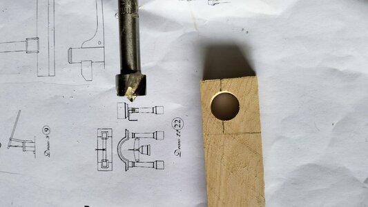

Finally some acceptable success with my entry level CNC machine. I still haven't got the software communicating with the machine but am happy to continue using the remote control for straight cuts at the moment.
These are 1mm slices done with a 2 flute straight bit.
More 2 pulley cuts to do on the 4 foremast bitts then I should be able to complete the foredeck planking.
Baby steps in this area of new (to me) technology.
Continuing with my little CNC machine. I am gradually developing better ways of clamping my work to speed the process. After this session I decided I will also add a 90 degree board to align the work piece.
The foremast bitts.
Brass tube was cut off in .7mm slices.
To provide a centre for the pulley axles I filled the pieces with Plastimake (an Australian made thermoplastic) .
After cleaning up the borders the brass "pulley wheels" were inserted in the slots and a .7mm nail driven through to provide the axle.
There is enough clearance to take the appropriate sail sheets when the rigging is applied.
Although this took several days of part time work to achieve I'm happy with the result and encouraged to keep experimenting with CNC.
The foremast bitts.
After cleaning up the borders the brass "pulley wheels" were inserted in the slots and a .7mm nail driven through to provide the fulcrum.
Ian, good job.
It wouldn't be a bad idea to paint the inside where the pulleys are red, too. Otherwise the white one catches your eye
