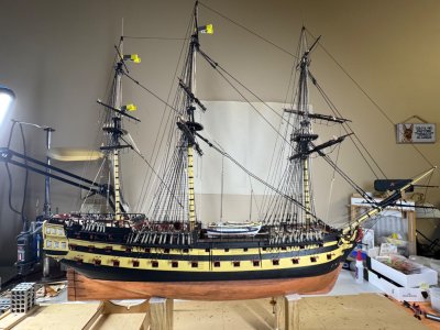

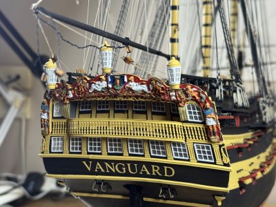

HMS Vanguard 1787 1:72 a Victory Models kit
Wow! that's is beautiful.
Thank you for your kind remarks. It is starting to look like a ship.
Starting to look pretty wonderful, Michael. As I have said before - rigging is your jam...
Thank you Paul. Your evaluation is well received and highly valued.
Absolutely beautiful work!
Thanks Andre. I think your work is outstanding but I haven’t seen any recent updates. I look forward to seeing your progress.

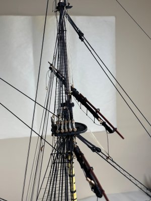

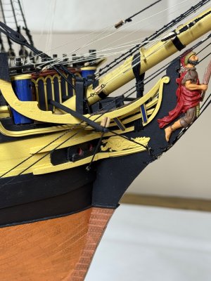

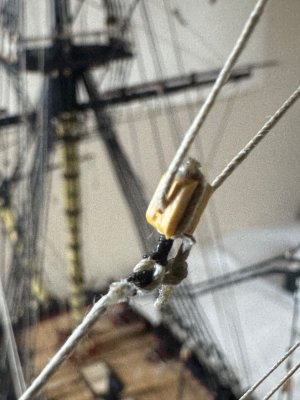

Hate to say it but the blocks are upside down :( The lines should run over the would-be sheave rather than under the sheave and over the tail piece of the block. You can drill additional hole though so you do not have to re-rig the blocks, IF you want to. I have no idea why, but this is a common mistake. Does the kit show the blocks like this?
Hi Allan, I share your observation. Franck
Thanks for the correction Allan and Franck. Unfortunately I am not disturbed enough by their orientation to redo them.
Hopefully it will not detract from the overall appearance. I will not make the same error on my next build.

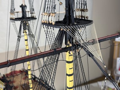

Did the kit supply the closed hearts used for the stays?
Thanks
Hi Allan. The kit supplied closed hearts but I purchased aftermarket open and closed hearts to replace the kit ones which I didn’t like.

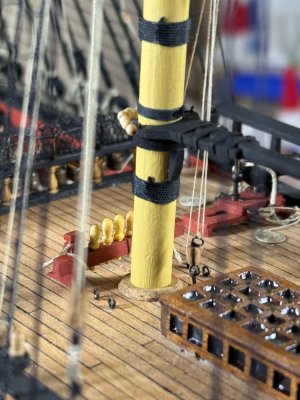

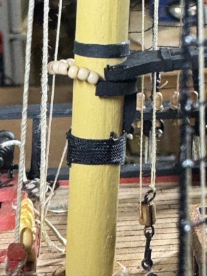

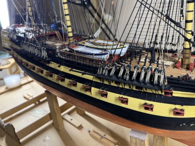

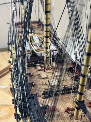

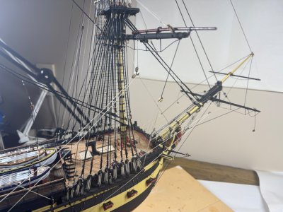

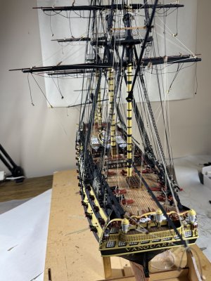

The rigging of the Vanguard continues.
I had to delay the installation of the gaff and driver boom due to lack of parral beads (trucks), to get wooden 2mm beads was very costly with most suppliers selling them as single beads. I needed 26 and they were selling at a price of $0.45AUD each. So I ordered beads from Temu https://www.temu.com/au/1000pcs-2mm...&refer_page_id=10009_1747559688337_d2hdbr4yyd and got 1000 for $2.06 AUD. The beads are a reasonable likeness of the wooden versions. Good colour.
The rigging is time consuming and getting harder as the number of lines and protruding parts that can catch my sleeve or be bumped by my hands as I rig is substantial.

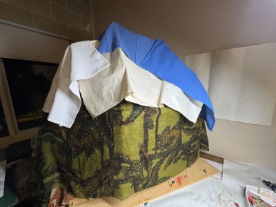

I build my model in my garage which is environmentally not insulated and so keeping the model dust free is a challenge.
I have developed a method of shrouding the model with a series of shawls the admiral donated and butchers paper and unused surgical hand towels. It takes about 7 minutes to drape and undrape the model.

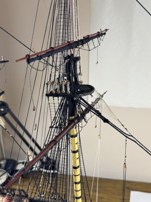

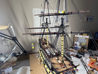

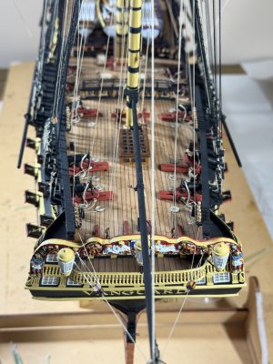

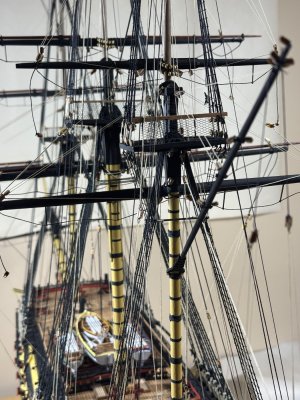

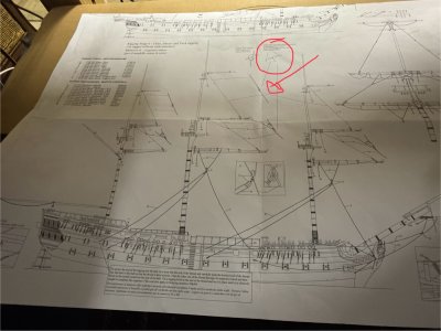

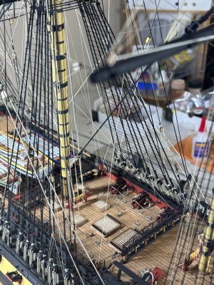

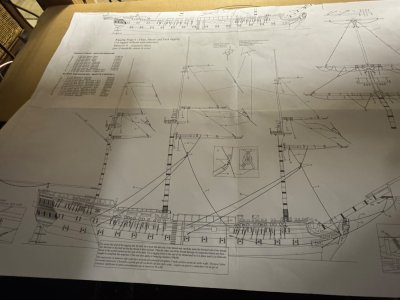

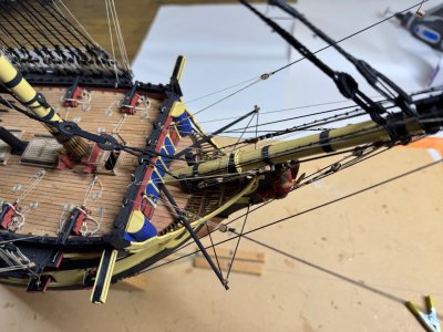

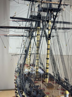

Rigging continues. As more of the running rigging gets installed it gets progressively more difficult to access the new lines and attach them to belaying points. I now know why the lowest yard on the mizzen is called a cross jack, the brace lines cross over beneath the stay. I have tried to show this in the photos, but its hard to see what’s going where.
I have completed the Clues, sheets and Tack rigging which are on Tavola 10. One thing I learnt and would recommend to those who are following is that some of the blocks on the yards are rigged with 0.75mm thread through a 3mm block, and the hole in the block would benefit from predrilling before mounting on the yards.

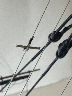

There are a number of Toggle points which were done using the method suggested by the instructions, to stiffen some thread 0.75mm natural with CA glue, which i did with a clamp hanging off it to get it perfectly straight.

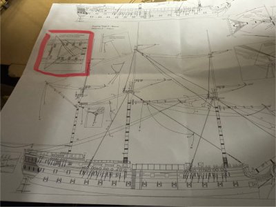

I am now on Tavola 11 and have started the Braces, with only Bowlines left to do after that.

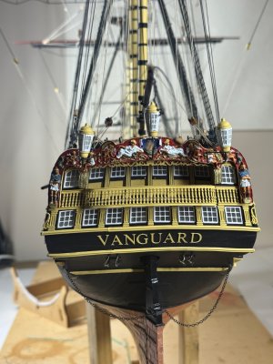

The other handy hint for future efforts is be very careful moving around the boom, I have brushed against it and ruptured the blocks off three times now. Also installed the rudder chains.
