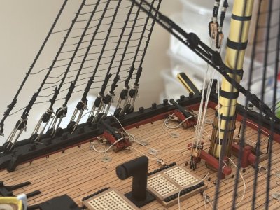

View attachment 488087View attachment 488088View attachment 488089View attachment 488090View attachment 488091View attachment 488092View attachment 488093Some small progress. All the masts now have caps and topmast in place. With the trestle trees attached. They are very delicate little pieces.
Also added the manropes to the bowsprit and used the technique of spacing the knots as described by Arthur (@aew ) and I think it worked well.
Starting doing the top shrouds.

Good morning. This is very good rigging. Your crows feet tension is brilliant, bowsprit hand line knots and deadeyes all in line create a wonderful symmetry on your ship. Way to go. Cheers Grant
Took me a while to catch up on your build. You have done really high quality work. extremely nice looking ship.

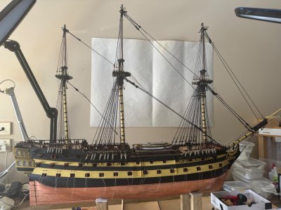

After a short Christmas break I’m back in the shipyard.
Have now finished the fore, main topmast stays and preventers and the mizzen stay. That completes the ten stay mice (?mouses) as part of the standing rigging.
Next job is ratlines for the top shrouds then moving up to topgallants.

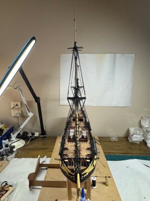

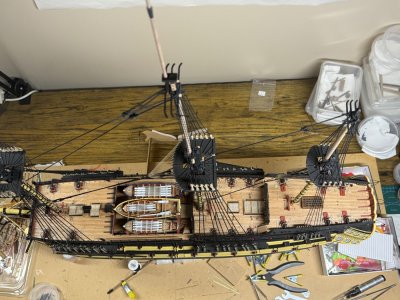

Well I have finished all the ratlines. :)
Added the jibboom and dolphin striker.
The model is now getting difficult to access and to photograph in one frame. I have installed the fore and main topgallant masts and tops. The crosstrees and trestletrees especially for the mizzen are very delicate and fragile and difficult to work with. If I did this again I would fabricate my own from stronger more dense wood.
I need a ladder to get to the top areas, probably a MI Tom Cruise style trapeze would be handy, but ladder will have to do.
All of this work for the last 4-5 months has been off one sheet, Tavola 8, amazing amount of stuff to do from one plan.
Thanks for stopping by.
Wow! She's turning into a real beauty!
The overhead shot is very interesting, but it feels like a pending 911 emergency as you lose your balance and end up impaled by the main mast. Chestcutter indeed...
Thanks Paul your interest is appreciated.
Perhaps I won’t use the ladder as a regular means of access.
I am still trying to improve my photography of the rigging details. The distant shots show the overall changes but fail to demonstrate the detail and magnitude of work done.

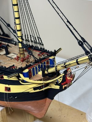

Only just managed to get back to the shipyard now and have completed the Part 2 of rigging and everything shown on Tavola 8 of the plans.
I mounted the figurehead and the top rails, and rigged the longboat tackles.
The next order of business is backstays and shifting stays followed by the lower yards.

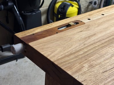

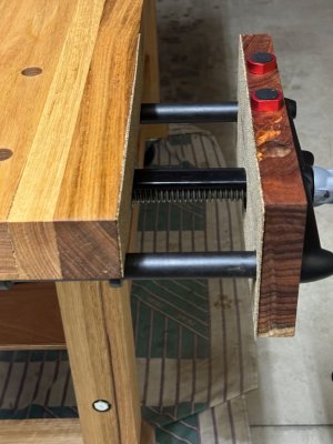

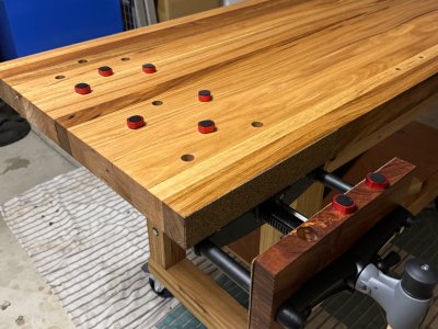

In the meantime I made a woodworking bench for larger projects.

The workmanship on your Victory stands above most - very well done! And your workbench - tres magnifique!
Russ Thank you for your kind words, they are so true. The ship is the Vanguard but is very similar to Victory so an easy mis-identification.
The workbench is inviting me to undertake some construction projects and an urge to buy some big boy tools to help along the way. ;)

Perhaps you should give the figurehead a ginger beard. Pets can steal your hear in unique ways, I have mourned a few cats more than I have people I knew.
Cats have a strong historical presence on tall ships, I am not sure why dogs do not.
I’m not inclined to memorialise Ginger in the figurehead’s face, but it is a nice thought. I will remember her everywhere I look.
