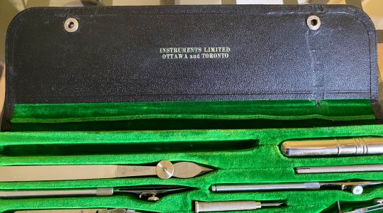

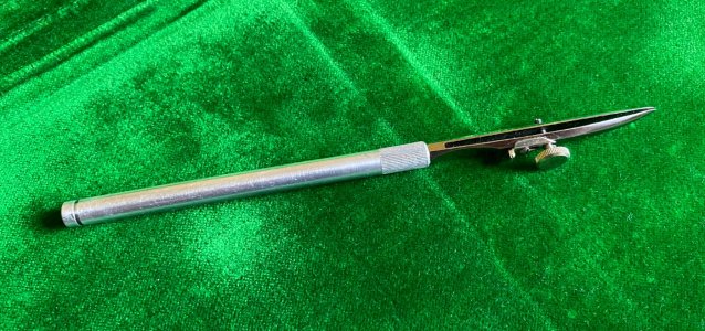

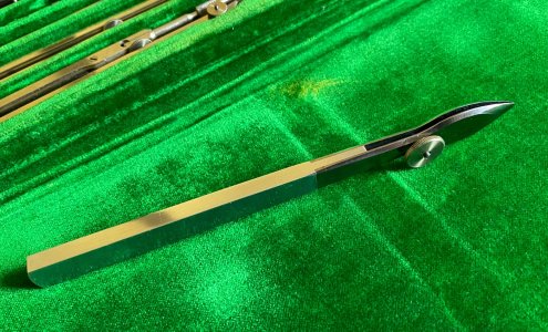

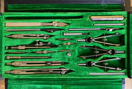

Look what a beautiful vintage drafting set I got from eBay. It cost me miserable 70 Canadian dollars with shipping. This is like $50 US. It’s Complete and in almost unused condition. It’s made circa 1945. People at the time were proud of the tools they made. I will use the ruling pens for drafting seams on my silkspan sails.

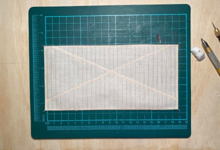

No. dockattner. Enough of silkspan for now. This stuff is too fragile. It is also not repairable. When it is broken, this is it. Nothing can be done. I am not comfortable with this idea. Thinking of making another 34 sails from silkspan for my Victory gives me creeps. A sudden move of my hand and sail is gone? No. I will try working with fabric again based on my experiences with silkspan.

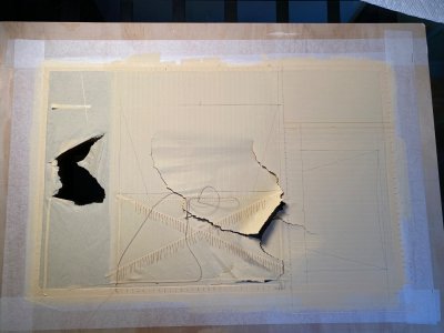

Here came the disaster. By pure accident the frame with one ready complete silkspan sail fell on the floor. It was about two meters height. Well. The whole thing had broken apart. There is no way to have it repaired.
"O" dear, Y.T.
Some lessons in model making are a lot harder than other's and this one looks pretty hard, it's good to hear you seem to be positive about the way forward.

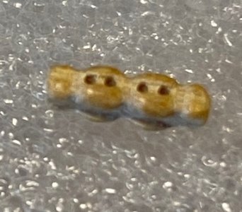

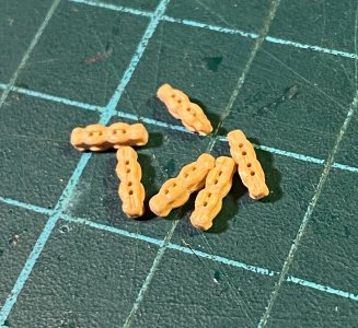

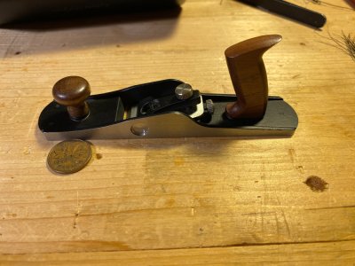

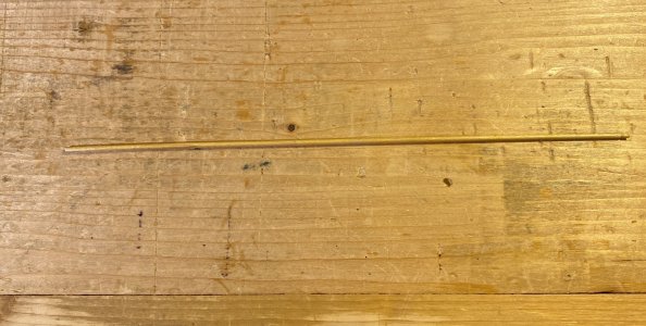

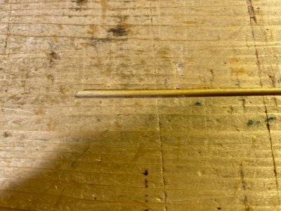

Today, the whole Boxing Day, I dedicated to fixing some problem that bothered me for alone while. For a long time I had seen that my Flying Jeep boom I installed long time ago, is way too flimsy. I am not able to have this piece of stick straight with all of the lines attached to it. The issue is I had made it out of hard maple and when it is downsized to about 2 mm diameter it flexes too much. Today I decided I will redo it with a more sturdy type of wood that was given actually with the Maoli kit. I do not know what kind of wood it is, but it is a really is intended to be used for masks and spas. It is flexible and sturdy. I had to repeat all of the dedicated tasks that I used to make the initial original piece.I had to use the delay. I had to use the mail I had to use the disk sander. I had to use my mini plane to make a round stock into eight side shaped section. The result really made me happy.mind you, I had to re-tighten and re-attach all of the lines that were used to attach to flying Jeep boom piece. Here are all of the pictures that I had taken.
