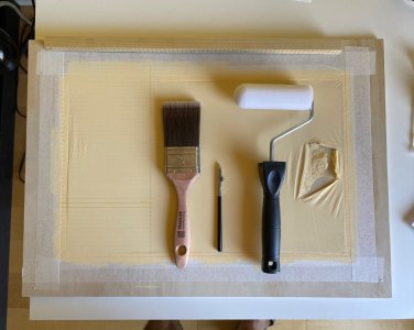

Then I decided going straight by the book (the booklet I mentioned above). I tried fixing and saving at least some of Silkspan on the frame. I went and purchased a good brush. It is 2" wide. I diluted the paint very much to have it mostly as a wash. I applied the paint on undamaged paper sheet. It went pretty well. See below.

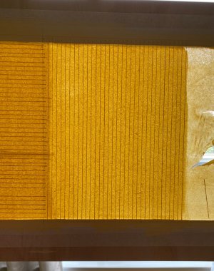

The Silkspan sags when paint is applied and later dries and tightens on the frame. Then It is possible to imitate the pieces of canvas parchment sewed together by drawing some lines on the sheet with a ruler pen loaded with paint. See it in pic above under the light behind. I screwed up lots of paper (seen on the left of the sheet) learning the technique.

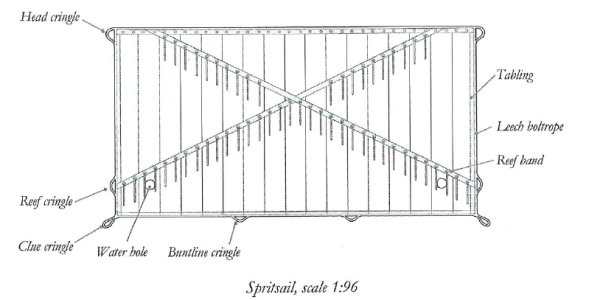

Now it is the time to outline the sail on the Silkspan sheet and to apply the reinforcement tablings. See some sail sketch below with the naming nomenclature of its elements for future reference. This is what I want my sails to look like when applied to my model. I had cut some slender pieces of the Silkspan to apply. I however do not have the proper gluing agent to glue them on. When I receive it I will continue.

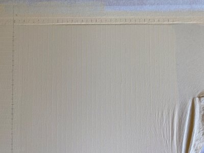

My main task for now is making a spritsail. Here what I managed to draw as an imitation of the pieces of 22 inch wide strips of canvas sewed together. Done by drawing some lines on the paper with a ruler pen loaded with paint. Doesn’t look bad to those who is having an imagination, is not it?
Hello J.T. It looks extreemly good, the line that you made with the ruler pen looks amazing. Would you please share this ruler pen image please?

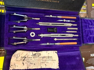

Just went back and noticed the pen as well. I need to pay better attention :( SOMEWHERE I had my old drawing equipment kit from 1965 for our drafting class. I still have the screw dividers but alas cannot find the kit and the ruling pens.
I do have just a little one remaining in a compass box as well, but I don´t know how to get such a definition in a line tha simulates extreemly well the sewing.
I may be seeing this incorrectly but I think the lines you see represent the seams that overlap one to two inches along the edge of the panels that make up the sail, not the sewing. At our most common scales there is no way to sew the seams of the panels or sail edges with thread that are even close to scale, especially at 1:90.
Look at the sails in the set of photos of the only known model with original sails from the 18th century, Tartar (20) 1734 at RMG and you will see the subtlety of the seams of the sails.
