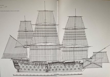

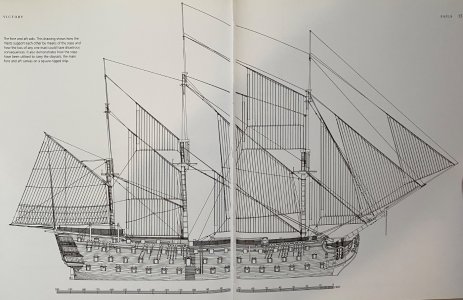

Another note. I understand the sail heights are somehow larger than the distance between the underside of the yard it hangs from and the yard below.this is to account for the sail to round off in the wind and to maximize its efficiency. As my sails are hanging in calm, I had to make them a bit shorter for presentation purposes so they do not interfere with structures below the sail.
As to possible question, where did I get the sale dimensions and pattern design, I got them scaled down from the picture in the book called HMS victory by McGowan.

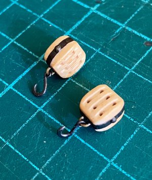

Really beautiful result with those triple blocks Y.T! I can tell you were working as a miniature blacksmith this copper wire to obtain this flat piece. Then is very good painted or chemically blacken?
