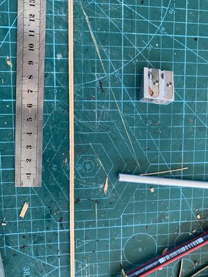

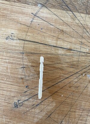

My philosophy exactly Thumbsup. I used my Dremmel and a 2x2mm birch and turned a super quick trial. Here it is. Going to play here a bit later today as I need to do better however I now know I can make these. Thanks for tip Dean.
Take your time and use a rat tail file for curved surfaces and triangular file for v notches. And of course the flat edge for a diameter. Between those three you can usually get any profile you want.
The other technique would be to cut the entire profile on a metal cutter, however you need a lathe at that point.
So a quick easy method is using a file and a drill. ;)

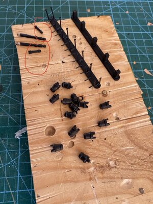

ROTFROTFROTFSorry but these stanchions (circled) I made for the stern part of the handrail look like Admiral Nelson went shopping at an adult store. I’m going to have to redo these just inappropriate ROTF :oops:. The other two where made with the dremmel and files. I am sadly lacking here. Still are way better than instructed. A lathe and model circular saw is definitely something we should all get. Before my next build for sure.
Grant :D:D:D !!! What would Nelson use those for? ROTF (The ones bought at Adult World?)

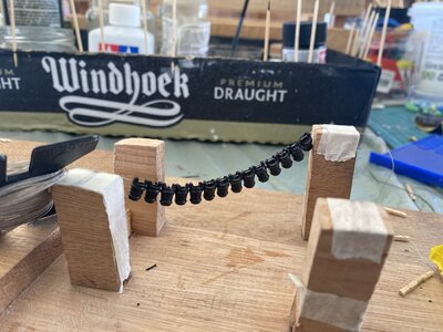

14 buckets on a string and an advert for Windhoek lager (good beer). I drilled a 0.3 mm hole through the “handles” which where not symmetrical and inserted a 0.25mm thread. I am debating on how to ensure each bucket will be at same height. This will visually impact the cabin section of the quarter deck if not achieved. Still thinking? After seeing them in line they are actually not so bad.
Grant, the buckets look great, as does the Windhoek. Agreed, a very good beer Thumbsup
In fact, after a few Windhoeks you won't care too much if your fire buckets are symmetrical or not ROTF

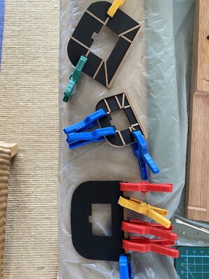

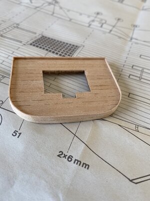

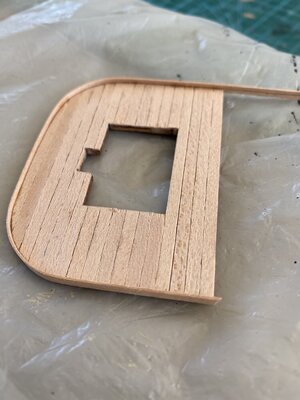

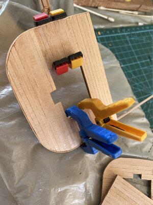

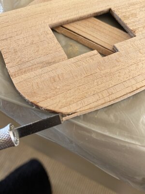

Good evening. Crows nest time. Planked and framed - used the 3mm x 0.5mm deck planking wood. I used wood glue and super glue “nails” for the framing and the 0.5mm planking bent around easily. As I am going to stain the decking I was careful not to get glue on the planks.

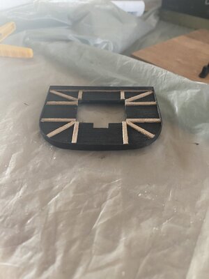

On having a look at various builds -yet another Victory by Bernd (Deagostini) and Jotika (caldercraft) website (has some good instructions and some drawings) it is clear that the frame needs to be higher than the base of the crows nest. Removed framing and redid.E37B17FD-9119-416C-8CA9-0BB9372E65BB.jpeg60B6976B-AA6D-449E-84F0-9BA34B605959.jpeg453AE584-550A-40BD-AC6E-1ED76B854FC2.jpeg

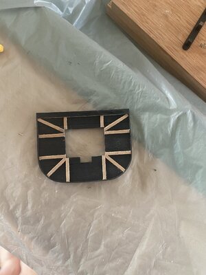

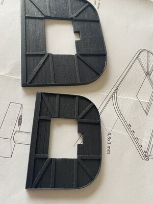

Stained planking with Indian Ink as it shows the wood planking better than painting. Added the individual “strakes” (Sorry guys cannot find what these are called) as per Mantua instructions. A little cleaning up and then dead eye installation.
I am debating wether to leave the wood effect(not authentic) or to stain these black as well.

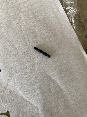

For my stanchions on the quarterdeck galleries (yes jumped back there:rolleyes:) I drilled a small 0.5 hole in bottom and CA glued a pin which I clipped to size. I was concerned as to the strength of these if just glued onto gallery. I have dry fitted. Drilled a 0.5 into deck. Will CA glue these into place once the hand rail is made.
This version looks less erotic...

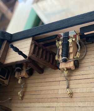

Cannon rigging looks GREAT!
