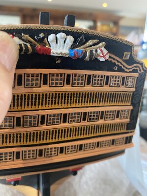

On this fine South African morning I am stumped.o_O. I decided to finally pluck up the courage and work on my stern cabin. The problem child for all modelers working with Mantua Victory kits(from the logs I have viewed)
I worked the lumps of brass provided with my dremmel and needle file and got some shape into them and clean up those which where ok.
Using photo below I attempted my first fine art project in my life. There is a sort of resemblance to the Portsmouth Victory stern decoration ROTFCautious . I soaked the brass in pool acid ( don’t take my advice on this but it works) for 5min, applied tamiya primer for metal (spray bottle) And used Tamiya acrylic gloss to paint the colors. The decorations which are the same color as the ship are Matt. Only gloss paint going on my Victory. Not a gloss fan.

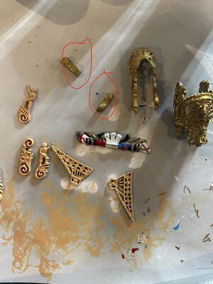

The red circle brass lumps I can do nothing about and cannot be used on my ship. They are simple and maybe @Dean62 will carve them for meROTFROTFROTF. I will give it a go.
Here is my stumping. When I put these against my stern cabin they are way too big! Like a 1:60 scale vs 1:78. I don’t get it. My skills are no where near @Dean62 or @dockattner or @Heinrich or @zoly99sask or @Daniel20 or @PT-2 ....can go on and on ;)to make these. The even more scary thing is my bow figure head is also way too big. Compare below photo to the above real ship. I have no idea. I guess my stern cabins and bow figure head will have to wait until I “figure” it out.:mad:.

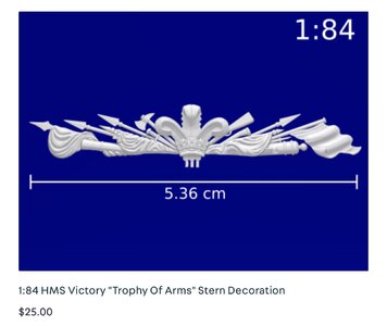

That’s very odd the stern decoration is so out of scale. But you are in luck, because the Victory is a popular ship.
Go to
https://www.shapeways.com/shops/victoryparts
…you can buy Victory scaled parts.
Looks much better than the kit provided piece. There are many pieces on the site you can buy, but it could get expensive. ;)
They have the figurehead, skylight, stove, stern decorations, etc.
All very high quality models!
Hi Dean. I did have a look at that site when this arose. They are very appealing. I will probably buy the figure head and the stern decoration as you showed. I hope they ship to SA. Is a problem getting parts wood etc for us. The others I am filing down and reworking and may get these right. Thanks for your feedback. Cheers

Shapeways does ship to SA- costs $84 +$34 dollars shipping fee. Hmm. My kit only cost $600. :rolleyes:.
