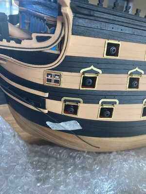

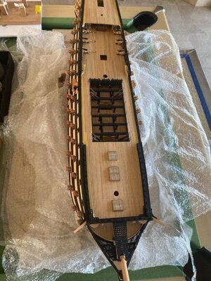

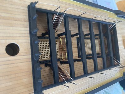

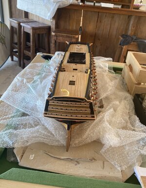

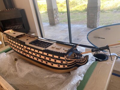

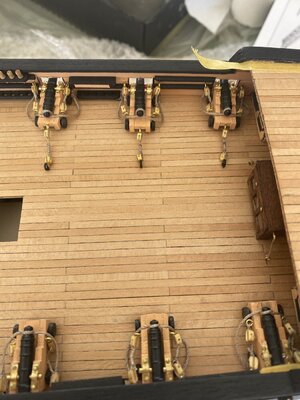

Finished the port side stanchions and rope rail of central waist. Ha ha pic makes it look like my pillar and stanchions angle upwards....better checkROTF.Did some pics of where I am at present.
The stern galleries still give me a head ache as what to do with the balustrades. The only real gripe I have with this kit) I could get a 3D molding?
51B7E86B-39E2-499A-A37B-7190DC5B02C6.jpeg58874FFF-598E-472C-A08A-A5611824CABE.jpeg376BC5EF-BD9F-4508-BE5B-98F80947F711.jpeg025C3621-2669-4759-A042-7B3F98444902.jpeg
The gratings are dry fitted as I had to use left overs to make the center one. (not enough provided for my earlier fix up of the gratings in central waist) and could not get the upper combs parallel with the Dp. Sasha going to send me to the stock ROTF. I am seeing if I can get some more with quick delivery to SA.

Grant, just rotate the grates 90 degrees. they are square. On the double one it is difficult to see, but everything seems to be correct.
Brain freeze there- yep I will do on the two square ones- the problem lies in center where I made the top of the forward portion parallel and the aft one opposite. Going to redo when get new gratings - which I hope match Mantua. Getting parts here is the problem. The private courier fees more than double the cost and many hobby shops (via Amazon or other) don’t deliver to SA,so I need to work out a bulk order.

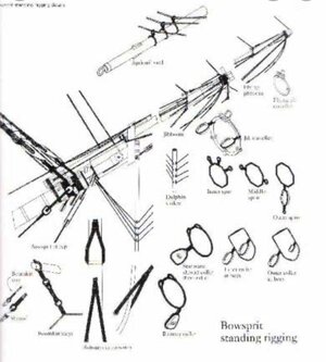

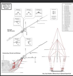

The rigging chart on my instructions seems to leave off a fair amount of rigging. I decide to play with the bowsprit standing rigging some more- looking at Caldercraft plans and a Alan McGowan and John McKay diagram there are two bowsprit shrouds on port and starboard. These run from the first and second stop cleats. In addition the dolphin striker shrouds run through blocks to the beak not back to bowsprit per Mantua instructions.
From what I found, The shroud dead eyes are single hole(terminology) and more triangular shape than shown in the Caldercraft plans and not blackened? They are also larger than the bobstay dead eyes so in my scale around 7mm. ......i thinkROTF.So many different interpretations to go for. Anyway going to add these. Now to find parts or make them.o_O. PS @dockattner the siren is singingROTF
View attachment 270980View attachment 270981
That's an awful lot of shipbuilding terms for a single post Grant. You're a quick study - or you have drunk the Kool Ade being poured by the sirens...

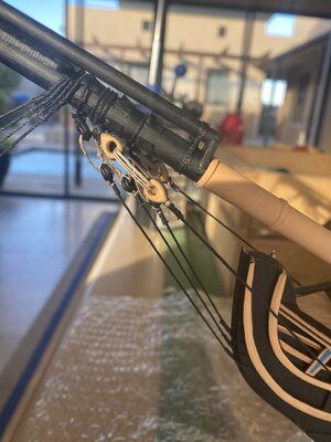

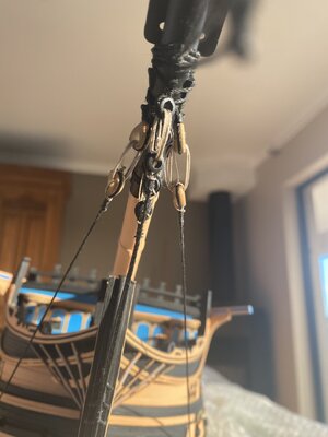

I made my bowsprit shrouds....man it is difficult to get rigging threads looking good. I’m glad I decided to practice here as there is more to learn about rigging than planking and fitting the hull and deck(well I think so).
Here is my attempt at these shrouds... have not fitted (held by masking tape) as I like to sleep on it and if I still like it tomorrow morning then I go for it.
