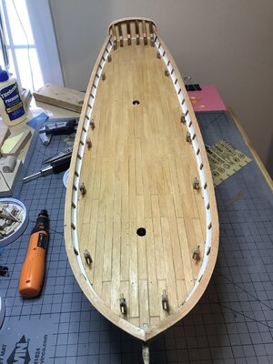

So this morning we managed to finish the bulwark rails.
I also used my deck template to spot and drill all the holes for the eye pins, the locations for the pumps and belaying pin racks.

Your progress may be limited by available time Jan, but is unmistakable. It is amazing how the completed railing lends frames the hull shape. After Christmas you can go full steam ahead again - so don't worry. :)

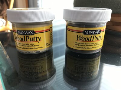

I left my home bubble yesterday and ventured out into the COVID world. It was off to the Hardware store to get some wood filler. I asked the clerk in the store what he would recommend other than what I had been using. He said he was a woodworker and recommended MINWAX Wood Putty. So I got two small jars, one in Natural Pine and the other in Walnut to take home and try. Not being a woodworker I didn’t tumble to “putty versus filler”.
The “Aha” moment.

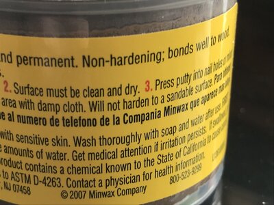

I tried out the Walnut on a couple of scrap pieces yesterday afternoon and was able to work it in very well. But if I had put on my reading glasses before I tried the stuff I would I would have known why the fix was still flexible this morning. :(:(
Jan

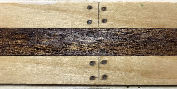

Wood putty and wood filler are two different items for different uses. I would still save it though, would work very well simulating trenails. Make a hole and fill it with the putty, when doing this I would be sure to have a coat of finish on the area to prevent possible staining. Experiment, it may not be a total loss.
Hi Don,
Thumbsup it's just another part of my learning process. Another piece of information filed away for future use. I'll experiment with the trenails. Maybe use the White Pine putty.
Jan
Lol, I’ve been to the local home stores many times looking at that exact same wood putty.
I did read about the “non-hardening feature” so put it back on the shelf.
Then a few months later I would go to get some putty, same exact stuff I put back on the shelf, read the fine print and realize my mistake.
Then a few months later ..... well you get where l’m going with this.
Hmmmmm, maybe I shouldn’t be telling these stories they don’t put me in the best light.

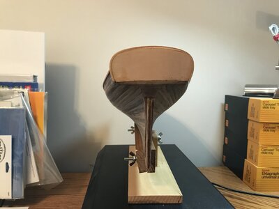

Well it's confession time. I have to admit when I started planking the hull, there were a few false starts. Eventually I found a method I could use, but it didn't exactly conform to the plans. In between have to taper the the planks both at the stem and stern, I wasted a lot of material just trying to get the first one or two planks laid down. My final method was to taper the planks toward the stem but not the stern. That worked out great, laid both the first and second planks and was content with overall result. Then it was time to do the transom. Argh, bummer, gee wiz, the Transom wasn't a very good fit. Evidently if I had managed to taper the planks at the stern there would have been a base to set the Transom on. Oh, well I put the hull to side for a week or so and every time I walked by I would pick it up, give it the evil eye and put it back on the shelf. Well this morning was the day, I just couldn't stand it any more, so....
Introducing the :p Jan Stern:p
Not according to the plan set, but acceptable non the less.

Nothing wrong with the shape, Jan! Are you going to plank over it yet? To me the only discrepancy is the texture between the transom and the hull - the shape and fit are both fine!
Hi Heinrich,
I thinkI will plank the Transom. It just looks it should be covered with something.
A small experiment, the holes are probably bigger than needed, but it looks like your idea will work. I did a coat of clear before and after I added the Walnut putty.

I like the treenail look, might give that a try on my next build.
I was eyeing how your planks butt into the stern, they look good to me, at least better than mine.
