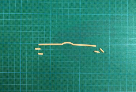

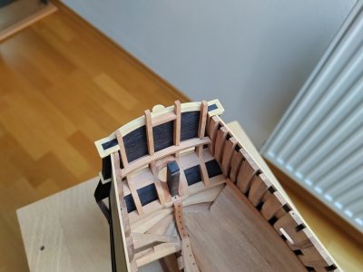

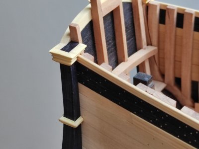

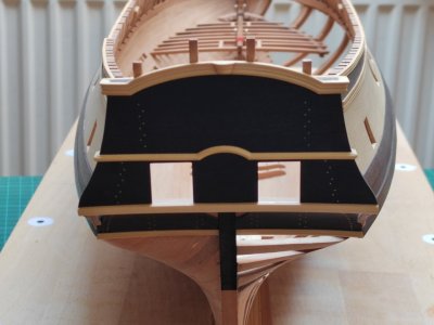

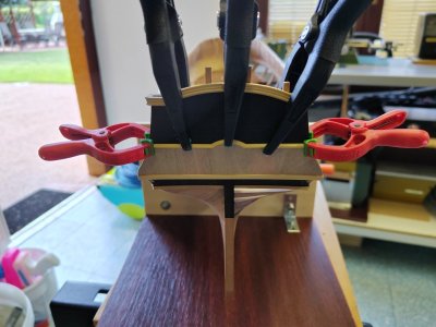

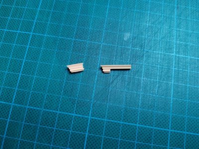

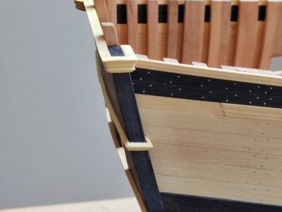

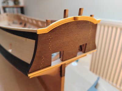

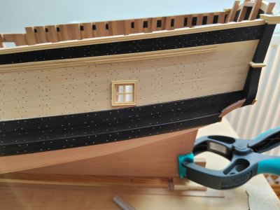

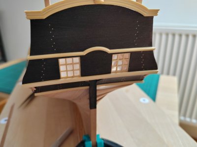

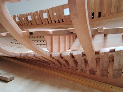

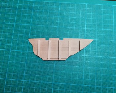

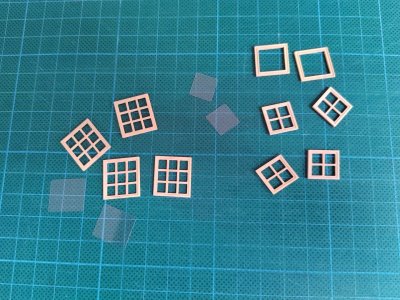

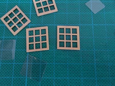

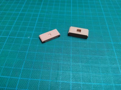

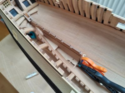

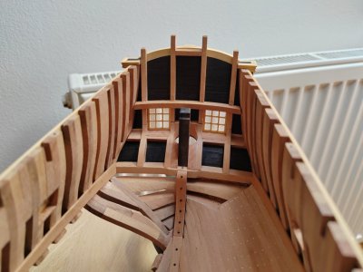

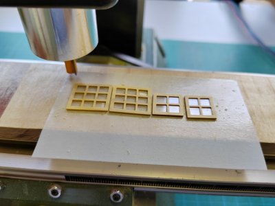

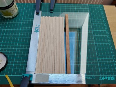

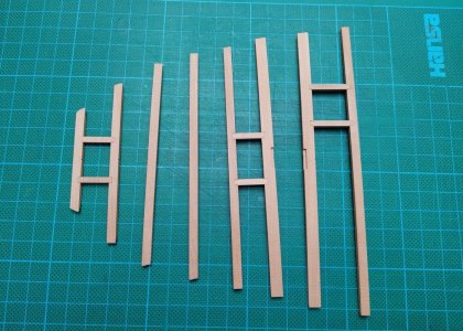

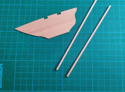

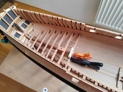

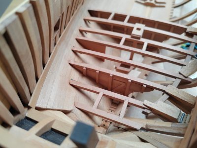

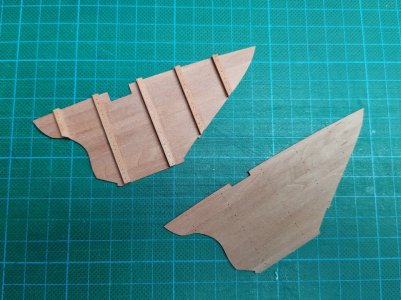

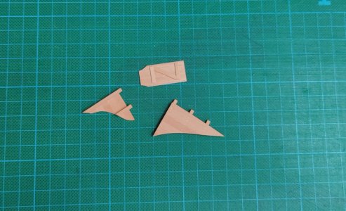

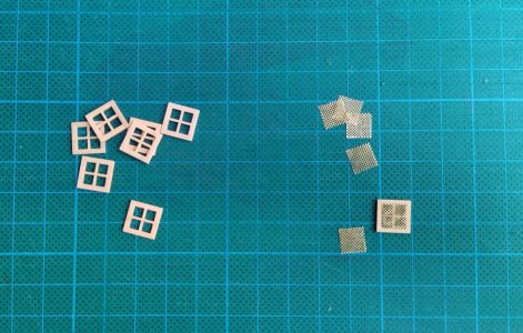

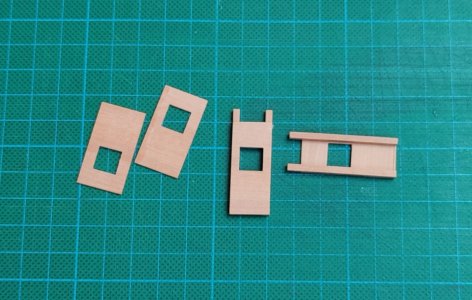

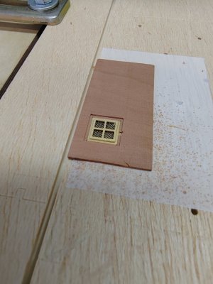

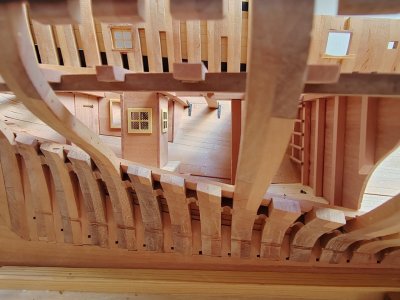

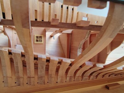

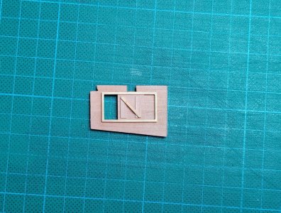

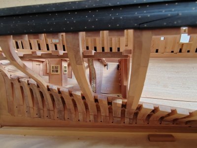

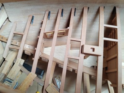

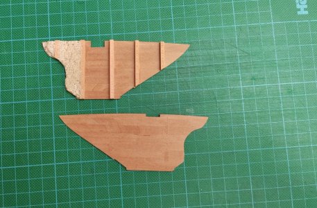

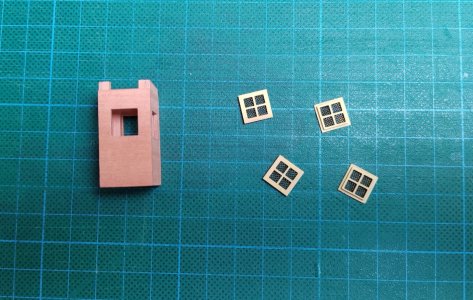

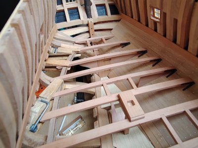

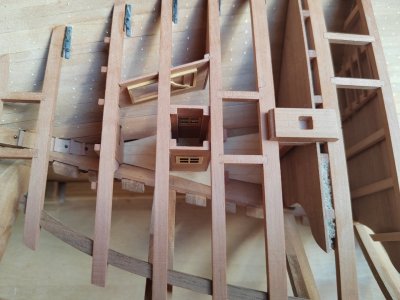

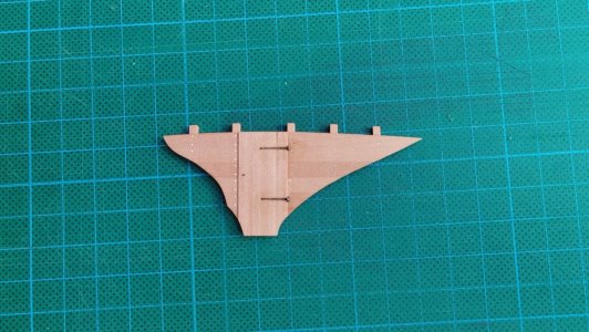

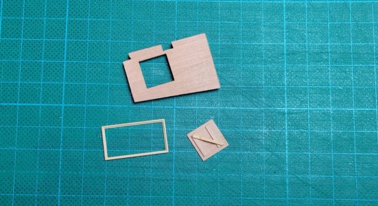

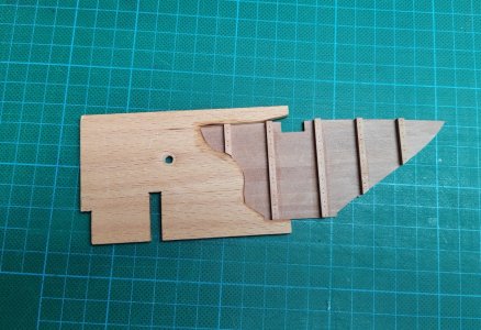

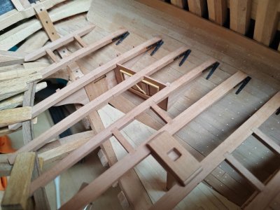

Windows - the last part on the stern, then I will continue on the inside of the hull. I chose the same method as for Le Gross Ventre - a frame made of two halves, in one half a pocket is milled for embedding plastic foil. After gluing, the whole is milled on both sides to the required thickness.
