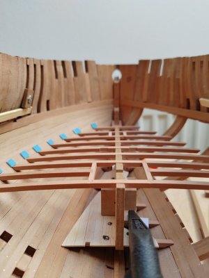

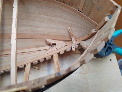

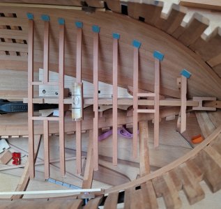

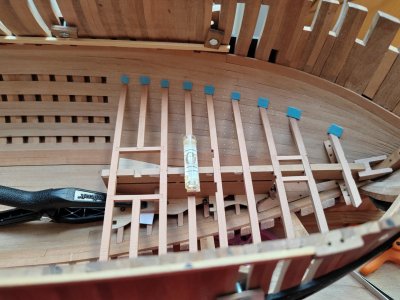

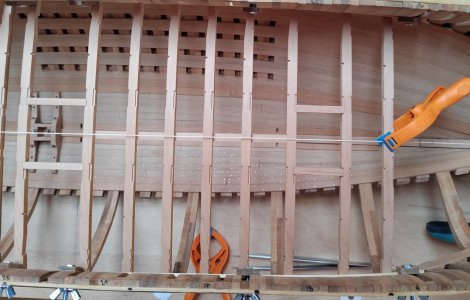

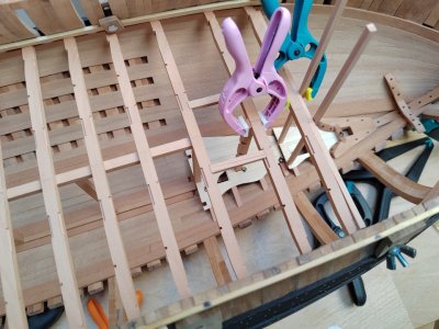

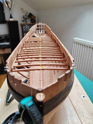

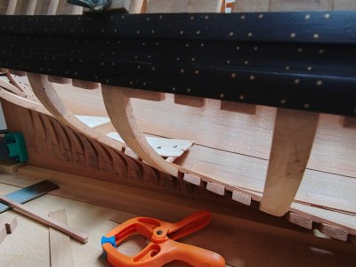

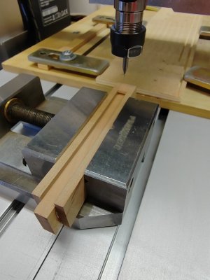

I continue with the deck beams in the front lower part of the hull. These deck beams will be attached to the inner planking on one side, on the other side, where the frames are cut out, the ends of the deck beams will be in the air, which somewhat complicates their installation. I made an auxiliary fixture for this purpose.
