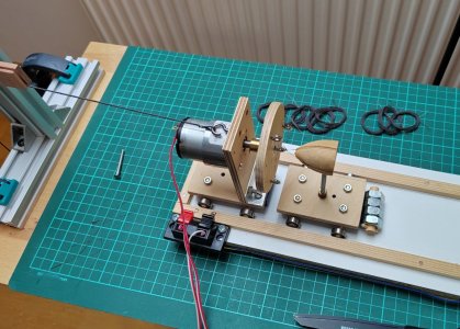

Sorry if you mentioned this earlier and I missed it, but what kind of material is your rope? It looks great!
To Marquiius - The ropes don't look bad in my opinion, and they hold their shape as best they can (though I prefer to knot each end) :). We'll see how the winding will look with thicker ropes, where there are more threads in each strand of rope.
To AllanKP69 - I use French cotton threads, which are pre-waxed according to the manufacturer, so the resulting cord is not as hairy as when using other classic cotton threads.
