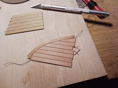

Supports are in & the main deck fits nicely in place.
I experimented simulating chalking with some scrap lumber & decided that using sewing thread looked the most realistic as you can see on the mortar deck. It needs to be trimmed, tree nails added & stained. Chalking the main deck in this manner will be tedious. Any thoughts on this technique?
Hi. I've been using it on my Hoy. It's a bit awkward, honestly, but it prevent hateful staining from pencil or dyeing. The outcome is also overall good, as the "true caulking" is evident even in 1:48 scale and the textile could fair minor misalignments occurring in the planking process. Regards.

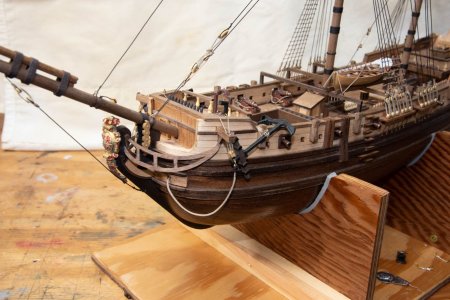

Hi everyone. After about a years hiatus from building my ship I started back up about a month ago. For me this is a winter project as I have other projects going on from spring through autumn. I also missed & did not record a lot of steps in my log. Sorry about that sometimes I become a little lazy when I shouldn't.

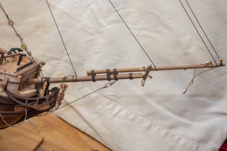

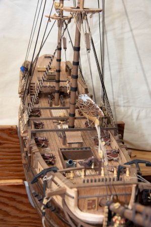

Anyway, in the last month I installed the mast & have most of the standing rigging up. now I'm working on the shrouds & ratlines. Instead of using the kit supplied rope I went with Syren Ship Model Co. rope which does not have the fuzziness. For the ratlines I think I may have gone a little too large (.45mm) & didn't notice until I had a few of them in place. For this 1:85 scale model I spaced them at 5mm apart.View attachment 554770View attachment 554771
Other then the rigging I upgraded a few other items including the life boat which is the Vanguard Models 18ft. cutter.View attachment 554778
The only thing, I am not happy with- THE WEBLINGS- I have allays kearnes that the diameter shoud be 4 to 5 times thinner than the shrouds.-sorry, el capi.
I habe build it. got the kit to my 50 years birthday, sn it must 32 years ago
I believe you are speaking about the ratlines. Their diameter has nothing to do with the size of the shrouds. The shrouds for the main mast, foremast, and mizen were all different as they were a proportion of their respective stays, but the lower mast and topmast ratlines were always about 1 1/2" in circumference no matter the size of the shrouds. I believe this was similar for most if not all, European navies.
