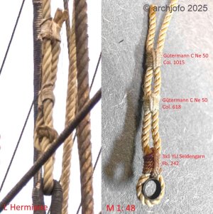

Continued: Running Rigging - Seizings
Before I continued rigging my French corvette, here the lifts of the fore yard, I asked myself the fundamental question of how and with what I should perform the required seizing of the running rigging.
In my search for an example of original rigging, I found what I was looking for in the replica of the L'Hermione. This appears to be the fore topsail halyard, a similar situation to the one used to attach the tackles for the lifts. As discussed several times in another forum, the running rigging was also lightly tarred, as was the spun yarn for the seizing.
In the following picture, I have compared three possible seizings for my model with the example from the L'Hermione.
Accordingly, I'll opt for the top option, as I believe it's closest to the original.
As already mentioned with the standing rigging, the need for thimbles for a sailing ship model is enormous. This, of course, also applies to the running rigging. Therefore, I'll have to make some more thimbles.
To be continued...
Witaj
Podoba mi się twój wybór Johanie wygląda bardzo ładnie, ale jak ty, że liny ruchome były lekko smołowane, aby móc atakować z tego samego koloru co lina ja tak zrobione w moim La bele poule. Pozdrawiam Mirka
