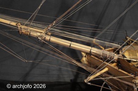

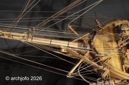

Bowsprit – Completion of the Running Rigging
Before continuing with the fore royal yard, I first turned to completing the running rigging at the bowsprit with the jibboom and outer jibboom of La Créole. The focus was on the jib (in this case: the rope carrying the traveller- Draille du grand foc) and flying jib stays (Draille de clinfoc), each led forward through the previously prepared travellers. These leather covered travellers have been waiting for some time to be fully integrated into the rigg.

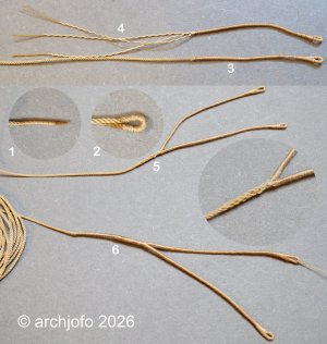

A particular point of interest was how these ropes were attached at the masthead in a way that allowed them to be released—either for striking the sails or due to wear. A historically documented solution uses a forked end, analogous to the stays. References included the Atlas du Génie Maritime and the original model in the Musée national de la Marine in Paris.

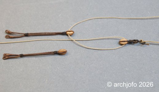

As on the prototype, a branch was spliced into the main rope, with each end terminating in an eye splice. This arrangement allows the jib and flying jib stays to be laid over the existing stays at the fore topmast head and fore topgallant masthead and secured with a lashing.
The following image shows the implementation of this detail with the individual work steps:

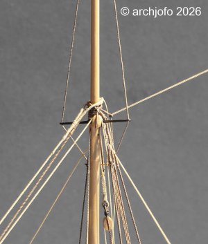

A particular feature in this context is the fore topmast preventer stay, fwhich simultaneously serves as the stay for the fore topmast staysail—a dual use also common in other navies. The storm jib (tourmentin), on the other hand, was only set when required on the solid fore preventer stay; no permanent fittings were provided. Accordingly, nothing is permanently installed on the model.
For the rigging of the halyards, I followed Jean Boudriot’s monograph strictly:
For the flying jib (clin foc) and the fore topmast staysail (petit foc), a simple halyard without purchase was used. For the jib (grand foc), however, I chose a two part halyard. The corresponding halyard block was executed with a block and hook.
The necessary blocks for the halyards at the fore topgallant masthead and fore topmast head also had to be installed. Since the monograph provides no details here, the Atlas du Génie Maritime and Coste’s Manuel de Gréement offered sufficient guidance. I made the block stropping so that the halyard blocks sit exactly at the height of the stays.

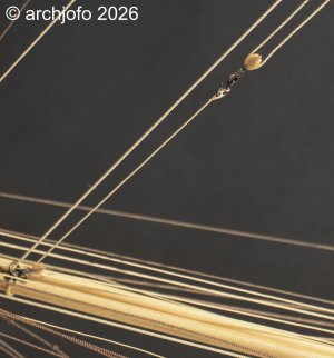

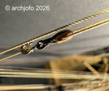

The following image shows the sail leader for the flying jib as well as the halyard block.
For the standing part of the two part jib halyard, I used a tour mort avec deux demi clefs—round turns with two half hitches—laid around the fore topmast head and secured with a seizing.
To secure the halyards of the fore topmast staysail, the jib, and the flying jib authentically when the sails are struck, I connected them to their respective downhauls. For the fore topmast staysail and the flying jib, this was done using the nœud de vache or nœud d’ajut (granny knot), not to be confused with the reef knot.
Source: Manuel du Gabier, 1875, p. 4
The nœud de vche (granny knot), is explicitly recommended in contemporary sources for temporary connections that must be easy to undo. Since no sail load is carried here and the purpose is merely to keep the running rigging tidy, I consider this solution historically plausible and operationally sound.
The jib halyard was connected to its downhaul via the hook. Suitable knots for this temporary connection were the nœud de griffe or nœud de palan.
Source: Manuel du Gabier; 1875, p.11
The sequence of maneuvers at the iron fairlead racks as shown in Boudriot’s monograph is schematic and follows the functional assignment of the ropes, rather than necessarily the actual geometric routing. In practice, however, the maneuvers must be ordered according to their physical position on the bowsprit—with the outer jib furthest outboard, the inner jib further inboard, and the bowlines of the upper square sails outboard—to avoid crossings, chafe points, and fouled leads.
Through extensive practical trials on the model, I have determined an empirically ideal rope routing that strictly adheres to these principles of seamanship: the further outboard the sail, the further outboard its respective maneuvers are situated on the sheave rack. The routing implemented here represents this realistic order and corresponds to the actual lead to be expected on comparable vessels of this era.

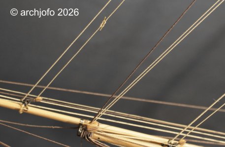

Thanks to the friendly remark from Andreas (@Cpt.Barbossa) I realized that the knot on the hook of the jib halyard was not executed correctly in my earlier version.
I have now re‑tied the knot properly — this is how it should look:
It is quite remarkable how the knot tightens itself around the hook in this configuration, holding securely while still being easy to release when needed.

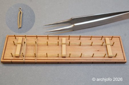

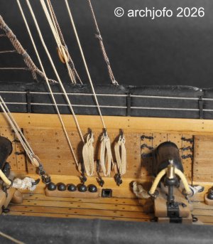

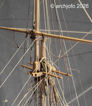

Belaying Points – Rope Coils
In the meantime, I have belayed a good part of the running rigging on the foremast. The jig for making the rope coils is now finished, as announced some time ago. With it, I can produce the coils from the leftover pieces of running rigging whenever needed.
The beginning of the line is fixed in the saw cut, then guided around the brass pins as shown, and the end is clamped again and trimmed. After brushing the coil with diluted white glue, it can be removed once dry. Thanks to the glue, the coil can later be slightly moistened and shaped so that it takes on a natural appearance when hung at its belaying point.
In the next photo, the belaying points for the fore topsail halyard, the fore topgallant stay halyard, and the fore topgallant halyard can be seen, together with their respective turning blocks.
More to follow …

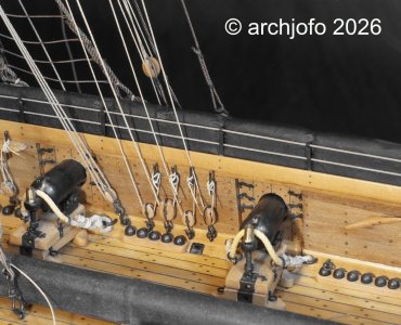

Installation of the Fore Royal Yard – Fore Royal Halyard – Vergue de petit cacatois – Drisse de petit cacatois
Before installing the fore royal yard, some additional research was necessary, as the belaying arrangement shown in Boudriot’s La Créole monograph did not seem consistent when compared with the fore topgallant halyard (belayed to starboard at the bulwark).
This prompted me to consult the standard contemporary references once again: F. A. Coste, Manuel de gréement (1826) and M. Verdier, Nouveau manuel complet de marine, première partie: gréement (1837).
Both authors state unambiguously that the fore royal halyard was belayed at the inner bulwark, immediately abaft the fore topgallant halyard. As far as I can trace the lead of the line, the original model appears to follow this arrangement as well.
As with the topgallant halyard, the fore royal halyard is led through a single‑sheave foot block hooked into the waterway. These blocks are fitted with iron hardware.
Here is the result on the model:
From left to right: fore topsail halyard, fore topmast staysail halyard, fore topgallant halyard, fore royal halyard.
The belaying points will later receive their coils.

Fore Topgallant and Fore Royal Halyards – A Translation Inaccuracy Leading to Twisted Logic
While reviewing my previous build log entry, I realized that I had fallen victim to a misinterpretation. The crucial sentence près du dormant de la drisse de perroquet – “near the standing part of the topgallant halyard” – had not fully revealed its meaning to me during my first translation. This led to a line of reasoning that kept bothering me: Why should the topgallant and royal halyards be belayed one behind the other on the same side, when French practice clearly favors a laterally separated arrangement?
This question continued to occupy me and simply wouldn’t let go. Only a renewed and very careful reading of the original texts by F. A. Coste (Manuel de gréement, 1826) and M. Verdier (Nouveau manuel complet de marine, première partie: gréement, 1837) finally clarified the matter:
On a two‑part topgallant halyard, the standing part (port side) and the hauling part (starboard side) are not on the same side. And with that, the belaying of the royal halyard becomes completely clear: The royal halyard belongs close to the standing part of the topgallant halyard, thus belayed on the port side — not behind the hauling part on the starboard side, as I had previously assumed.
Accordingly, I only need to belay the fore royal halyard and the standing part of the fore topgallant halyard on the opposite sides.
This experience has shown me how quickly a small inaccuracy — whether in translation, interpretation, or simply a first impression — can steer an entire conclusion in the wrong direction. I was too quick to accept my initial assumption as correct and to publish it, without taking the inner inconsistency seriously enough.
The second, deliberately careful look then confirmed that my first interpretation had been wrong. For me, this is a clear lesson: Before posting something online, it is worth pausing for a moment, examining it critically, and questioning one’s own interpretation.
