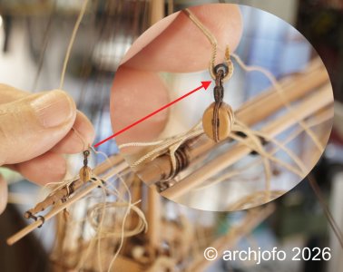

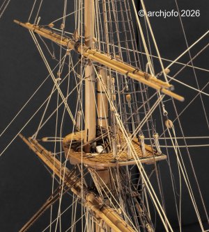

Attaching the Fore Topsail Yard - Vergue de hune de misaine
Now that the fore yard has been rigged, we'll proceed with attaching the fore topsail yard, working systematically from the bottom up. For this, it's necessary to install the corresponding fore topsail tye.
The tye's components - including the topsail halyard spacers (gouvernail de drisse) and tackle - were manufactured and documented some time ago; the blocks are also already in place on the model.
During the preparation, the question arose as to the correct tarring or coloring of the tye with halyard. A recent close-up photograph of the Hermione replica shows the the rope of the tye just before the tackle block, in direct comparison to the backstay that guides the topsail halyard.
Source: Association Hermione – La Fayette, “Dico de l’Hermione”, December 9, Itague.
The image clearly shows that the topsail tye is visibly lighter in color and therefore only lightly tarred, if at all, in contrast to the heavily tarred backstay. This likely corresponds to historical practice. The fore topsail tye is part of the running rigging.
The tye in general (fore topsail yard ø 37 mm) was served in the sections where it passed through the blocks (according to F. A. Coste 1827). Therefore, to prepare for the fore topsail tye, this area had to be defined on the model. Appropriate markings were made on a temporarily installed section of rope. At each end of the tye, there was a spliced eye for attaching the halyard blocks. These sections also received appropriate serving, as can be seen in the following pictures.
I prepared the lashings for the halyard spacers in the form of rings made from thin silk yarn. I was then able to stiffen these rings with diluted white glue and pull them onto the rope, sliding them over the spacer at the appropriate points.
One side of the topsail tye with halyard could be made completely, and therefore conveniently, outside the model.
Only after the rope is threaded through the blocks can the other side (with the serving already prepared, and silk thread for the remaining serving) be finished on the model, albeit somewhat less conveniently.
Attaching the halyard spacers requires opening the seizings of the fore topsail backstays. Unfortunately, I didn't consider that something would be added there when rigging the standing rigging.
The following pictures show the fore topsail tye already installed in the block of the middle of the fore topsail yard.
The last picture shows both tye blocks under the braiding of the shrouds with the already pulled-in tye rope.
In the next step, I will then complete the starboard side of the tye with halyard.
To be continued...

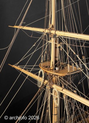

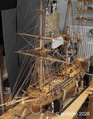

Continued: Fore topsail yard – tye, lifts, clewline, braces, bowlines – Itague, balancines, cargue-points, bras, boulines
I have now completed the tye on the starboard side as well, including the fore topsail halyard. The double block of the fore topsail halyard tackle was tied directly to the model, and the halyard spacer was attached, as can be seen in the following pictures.
The next picture shows the single block of the halyard tackle with a long strop, which has been hooked onto the channel with a swivel hook. The released fore topmast backstay, into which the tackle had to be reattached, is also visible.
Furthermore, I was now able to connect the fore topsail sheets to the clew lines of the fore topsail using toggles. The lifts were also threaded into the topmast sister blocks and led down. I also attached the braces and bowlines. I had already pre-cut all these ropes and prepared them with the blocks.
Finally, here's an impression of the current state of the rigging work on the foremast. The rigging is progressing steadily, even if it all looks a bit unsteady at the moment.
Until next time…

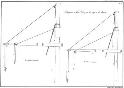

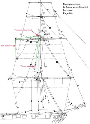

Continued: Fore topsail yard – Reef tackle – Palanquin de ris
Several aspects of the reef tackles (palanquins de ris) on La Créole initially remained unclear. The monograph specifies tackles located at the top, yet neither the original Paris model of La Créole nor other contemporary models in the Musée national de la Marine show such fittings.
The Atlas du Génie Maritime includes illustrations of reef tackles, but likewise without tackles. This suggests that on La Créole, the reef tackles ran via the sheaves of the yardarms to the topmast, were led through the topmast sister block (poulies de baraquettes), and then—without a tackle—through the lubber’s hole, over the fairlead block, and finally to the pin rail aft of the foremast.
Source: Atlas du Génie Maritime
Contemporary technical literature, such as F.A. Coste's Manuel du gréement (1829), mentions tackles, but these refer primarily to larger ships.
Whether blocks were attached to the reef tackles of the La Créole—as depicted in the Atlas du Génie Maritime—is uncertain. On the original Paris model, the reef tackles are simply attached to the sheaves of the yardarms with knots (e.g., figure-eight knots), as the model is rigged without sails.
However, reef blocks seem particularly useful without tackles, as they significantly facilitate reefing—a practical advantage in every respect.
The La Bergère model (1832) features reef tackles with reef blocks. Since this model was also rigged without sails, the reef tackles was attached to the fittings of the topmast shrouds. Particularly compelling is the comparison with the La Bergère, a corvette of nearly the same size from the same era, which also features reef tackles without tackles, but with reef blocks.
Based on my research, I've come to the following conclusion for my corvette:

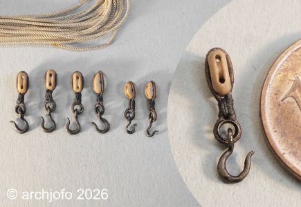

I will use reef tackles without tackles, but with reef blocks.
This results in six additional blocks with hooks in the size range of approximately 3.5–4.5 mm-
a consequence I can live with...:D
To be continued…

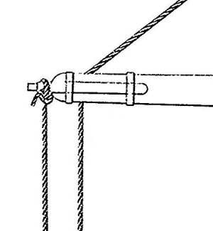

Continued: Topmast Yard – Reef Tackles, Buntlines and Leechlines – Palanquin de ris, cargue‑fonds et cargue‑boulines
In the course of the work on the fore topmast yard, I recently finalised the routing and execution of the reef tackles. One detail, however, remained unresolved: how, historically, was the standing part of the reef tackle secured to the yardarm of the topmast yard?
The Atlas du Génie Maritime clearly shows the lead of the tackle, but does not reveal the precise method of fastening.
Quelle: – Atlas du Génie Maritime, annexe Nr. 1, Pl. 25 - Bildausschnitt
To clarify this point, I consulted additional contemporary French literature and found in the Manuel du Gabier (1875) the tour mort avec des demi‑clefs (a round turn with half‑hitches), described there as the “most commonly used” method for fastening the end of a rope to spars, yards or other easily encircled parts of the rigging.Manuel_du_Gabier_1875.jpg.f5a51cfb62684d692ef2b30d535fb1c4.jpg
Quelle: Manuel du Gabier, Paris 1875
Combined with the representation in the Atlas du Génie Maritime, this results in a coherent and historically plausible solution: the standing part of the reef tackle is secured to the yardarm with a round turn and two half‑hitches.

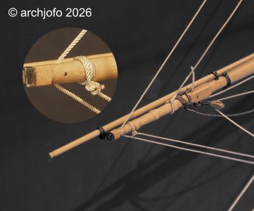

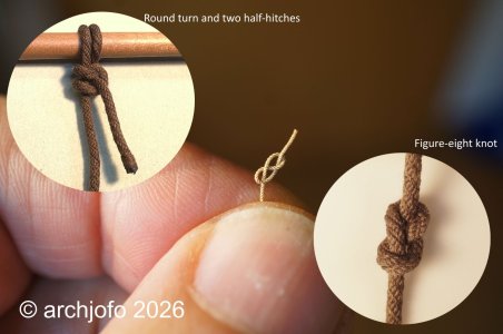

To illustrate the knots used on the fore topmast yard, I show three examples here: – on the left, a round turn with two half‑hitches for the standing part of the reef tackle, – on the right, a figure‑eight knot as a safeguard against slipping, – in the centre, a figure‑eight knot tied in 0.25 mm rope at model scale to demonstrate the actual fineness of the work.

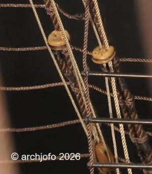

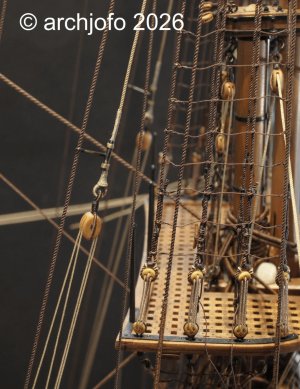

In the meantime, the blocks for the reef tackles (palanquins de ris) have also been made and fitted with their strops and hooks.
In the next image, the buntlines can be seen, running through the cheek blocks on the trestle trees, as well as the leechlines, which lead over the blocks seized to the fore topgallant stay. Also visible in this picture, on the port side, is the sister block with the reef tackle and the lift.
The following image shows the port reef tackle with its standing part, as it returns from the reef block towards the sheave in the yardarm, running in the direction of the topmast sister block.
Finally, a close‑up of the standing part of the reef tackle: round turn with two half‑hitches.

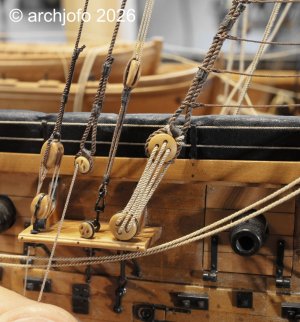

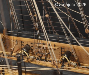

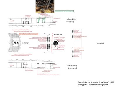

Continued: Securing the running rigging on the fore and fore topsail yards
Nothing particularly spectacular is happening on my model at the moment – apart from occasionally getting annoyed with my own clumsiness. When working with the headband magnifier, I keep getting caught in the rigging. Especially when securing the lines, you need a greater working distance, and instinctively you move closer to the model to see the details better.
So far, I've been lucky, and nothing serious has happened. The main problem with the headband magnifier is its relatively large front section. Therefore, I'm now going to try a clip-on magnifier that attaches directly to the eyeglass frame. If I remember correctly, Daniel @dafi works very successfully with such a system – and his delicate results speak for themselves.

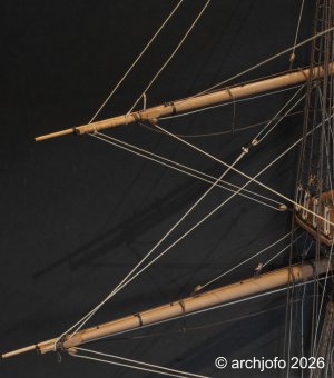

Currently, I'm securing the running rigging on the fore and fore topsail yards. It's important that the lines don't cross and are led as freely as possible downwards to their respective securing points. The ropes running through the guide blocks (moques de conduits) on the shrouds and the turning blocks in the water channel require special attention. Especially with the ropes running over the guide blocks, a good feel for the correct tension is essential. Too much tension pulls the shrouds inwards unintentionally, while too little makes the ropes appear loose and disorganized. I'm not yet permanently shortening the rope ends at the belaying points, so I can readjust them later if necessary.
The belaying plan I've created for the foremast – including the bowsprit and jib – is based primarily on the findings from the monograph, contemporary literature, and the original Paris model. The three sources complement each other well: the monograph provides the system, the Paris model demonstrates the practical implementation, and the contemporary descriptions help with the details of the rope routing. I will determine the belaying for the mainmast and mizzenmast in the same manner.
To conclude my report today, here are a few photos showing the progress of the rigging work:
To be continued…
