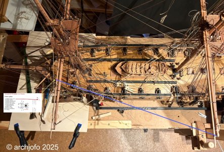

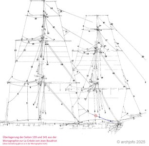

Supplementary Note on the Routing of the Mainsail Bowlines
To further illustrate the issue described above regarding the routing of the mainsail bowlines (blue lines), I’d like to share two visual references. These are based on cropped images of my model and excerpts from Boudriot’s monograph, and are intended to clarify the technical challenge posed by the forward-leading arrangement.
From my perspective, the solution depicted in the monograph—leading the bowlines over the foredeck—raises questions, particularly with regard to potential interference with the foremast rigging.
This configuration seems unusual when compared to other period models, where bowlines are typically belayed aft of the foremast.
I’d be very interested to hear your thoughts on this matter, and whether similar arrangements have been documented elsewhere.

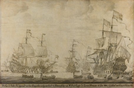

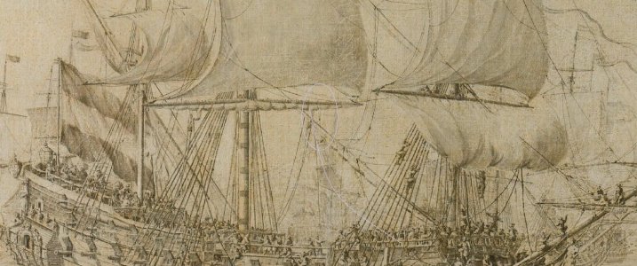

@Steef66
Hello Stephan,
Thanks for the impressive pictures. I also think this is a plausible way of laying the mainsail bow lines.
Here I'm showing an example from a French ship, the Foudroyante from 1794. There, the mainsail bowlines are attached aft of the foremast.
I got this link of the Dutch ship "De gerechtigheid" but the link is death for the moment. I should not be like that.
Another one 1666 De krijgsraad v/d Velde

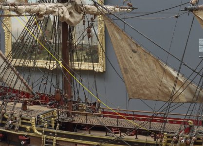

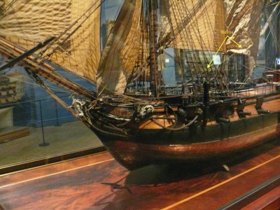

If the model is without sails, then the bowlines of the lower sails do not need to be installed - according to the French rules, these bowlines were removed. When the sails were secured to the yards, the bowlines were re-set. The French scheme involved laying bowlines to the after bitts of the foremast or to blocks on the deck next to them.
Dutch, English, Russian and Spanish schemes are not suitable.
Bowline sails can be found on models from the Paris Marine Museum collection, but only on models with sails.

Great example, which ship and from which year is this ship a model?

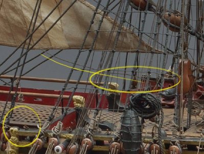

@iutar
Hello,
Thank you for your insightful remarks regarding the French approach to bowlines on models without set sails.
In this context, I’d be very interested to know which source supports your statement that “according to French rules, these bowlines were removed.” Is there a specific regulation, a contemporary document, or a monograph that clearly outlines this practice?
As a complementary note, I’d like to point out that the Paris Marine Museum does feature models without sails where bowlines are attached at the center of the yards – albeit without the corresponding bowline bridles.
One such example is the Friedland (1810). Likewise, the original model of the La Créole includes bowlines, as documented in several of my posts and illustrated through cropped images of the Paris original. Only the bowlines of the mainsail are absent.
Rigging of the Mainsail Bowlines – Boulines de grande voile
In the meantime, I have been able to clarify the principle of how the mainsail bowlines were rigged on my French corvette through the study of contemporary technical literature. It is important to maintain both the chronological and geographical context.
My findings are consistent with the observations made on the period models in the Musée national de la Marine.
The mainsail bowlines were led through snatch blocks (fr. poulie coupée), which were attached amidships on the deck abaft the foremast and belayed, for example, at the pin rail behind the foremast. Since the mainsail bowlines of larger ships required considerable force, they were usually double-purchased. Accordingly, blocks were fitted at the ends of the bowline bridles through which the bowlines were rove. Whenever the bowlines were not in use, they were unrove from the snatch blocks. Whether La Créole actually carried double-purchased bowlines could not be determined with certainty.
What is decisive, however, is a finding from contemporary literature:
The mainsail bowlines were not permanently rigged, in contrast to those of all the other sails. They were only bent on when actually needed; otherwise, they were kept ready for use on the foredeck.
Source: Nouveau Manuel complet de Marine by M. Verdier, Capitaine de Corvette, Paris 1837, p. 175.
This also explains why, on the period models (rigged without sails) in the Paris museum, bowlines are always to be seen on the other yards – but never on the main yard. The same applies to the original model of La Créole.
For this reason, I will consequently not represent mainsail bowlines on my model.
