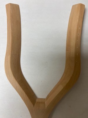

I love your work, Chris! Centerline timbers look perfect!

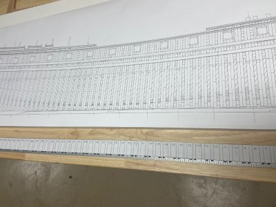

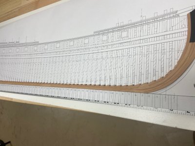

Thanks, Chris. I was asking more specifically about Boudriot's La Renommee. I have the monograph and know he draws half frames. I was wondering if there were full frame drawings commercially available.Depends on the author of the Monograph - Boudriot and Lemineur do not illustrate full frames. Delacroix does - which still requires making copies of them, tracing or drafting during construction.
I had the advantage of one of my friends in the French forum share the frames for Renommee he uploaded into pdf form as full frames which was a huge advantage. I could print the frames with ease on my home computer which sped up the process considerably.
