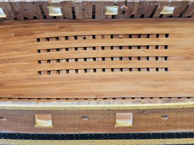

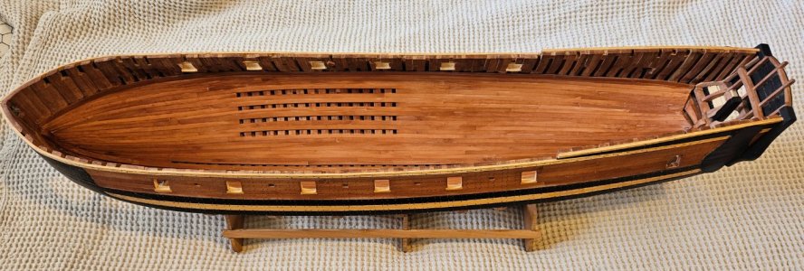

Hello dear friends

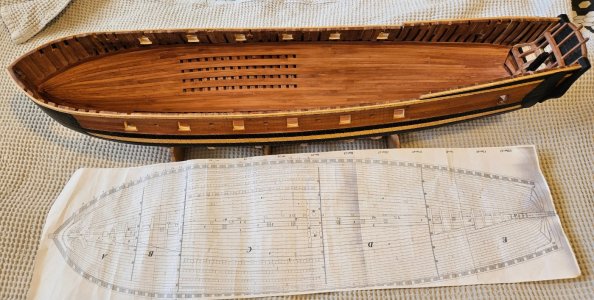

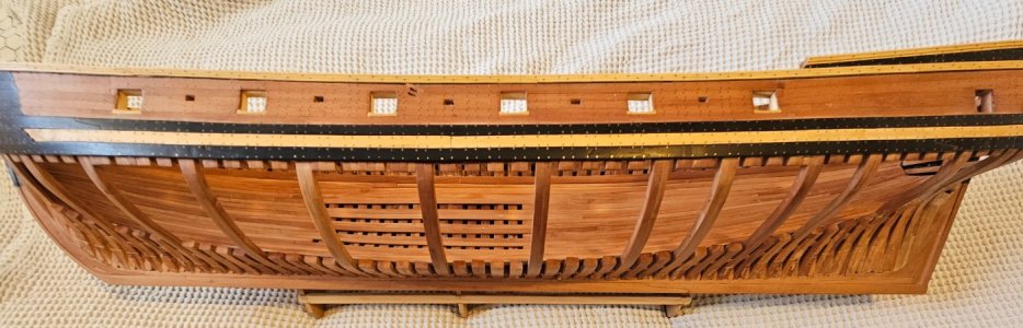

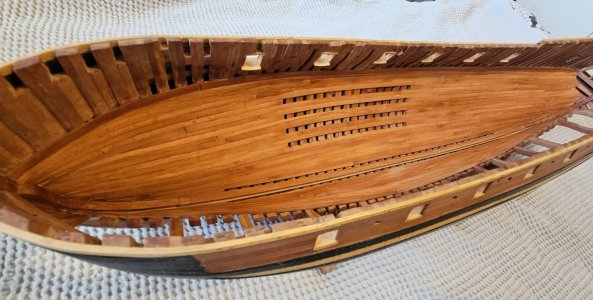

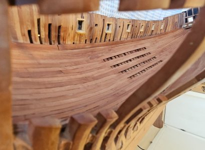

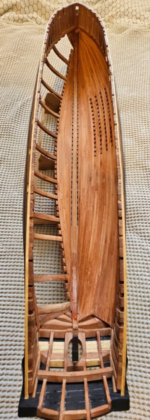

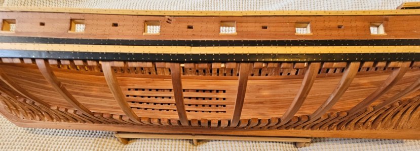

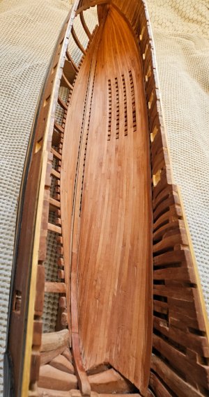

It's have been a few weeks since my last update, these weeks were dedicated to creating the inner planking of the ship's side.
Today I finished installing the inner part of the ship's deck.
Next week I will install the brass nails.
I would like to wish you all a happy and sweet New Year's Eve starting tonight.
I wish us all a year of happiness, joy, success, peace and tranquility.
May we continue to be friends and enjoy our special hobby
20250922_164521.jpg20250922_164839.jpg20250922_164919.jpg20250922_165018.jpg20250922_165124.jpg20250922_165458.jpg20250922_165701.jpg20250922_165118.jpg20250922_170100.jpg

A nice personal touch, Shota. With the different wood colors and ‘looking through parts’.
I agree with above. The wood tones are beautiful.
I like being able to clearly see the internals on your beautiful ship Shota.
Beautiful !!! She looks great ! your work is wonderful !
A very interesting presentation, Shota!
The ship is coming along nicely! I like the mixed tonality of the browns in your wood. Too often it is so "even coloured", it is actually rather dull.

Thank you all And to all the other good friends so much for the warm words and compliments, for the likes and smileys full of love.
The different shades are created from different Swiss/European pear trees, I'm glad they pleased you.

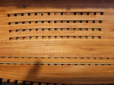

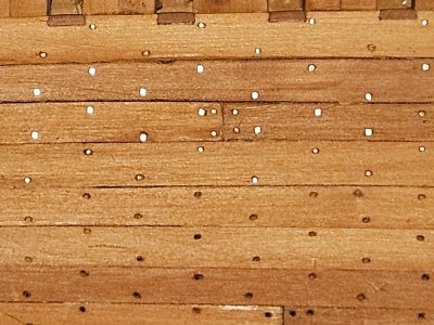

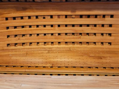

Today I started to installing the nails on the planking boards of the inner wall.

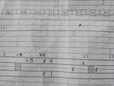

I am attaching the drawing of the monograph which shows that there are two sizes of nails, the largest in boards 6-7 and all the rest are small. I chose a square wire of 0.6 mm and a wire of 0.4 mm.
I am attaching a first and small section of the work, about 130 out of about 2000.
