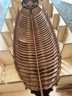

Frames 1 to 26 now completed:
The bevels have swapped sides - the outside bevel (for the clinker planking) is now on the aft face of the frame, while the inside bevel (for the ceilings) is now on the forward face of the frame.
It’s a bit of a fiddle fitting the frames where there are plywood cross pieces in the jig. As you can see, these cross pieces have steps which correspond to the steps on the frames and occasionally minor adjustments are needed to frame and jig.
Kind regards
Salty
Thank you to all who have been following my progress to date. I thought I might be a little hidden way in this part of Ships of Scale forum, but apparently not so…
Frames 1 to 35, plus the keelson:
The frames need care to avoid breakages when bevelling as the glued area is decreasing. One or two have occurred, but they have been clean and not difficult to repair. I think overlapping sections of the frames form a satisfying pattern as the jig fills up.
