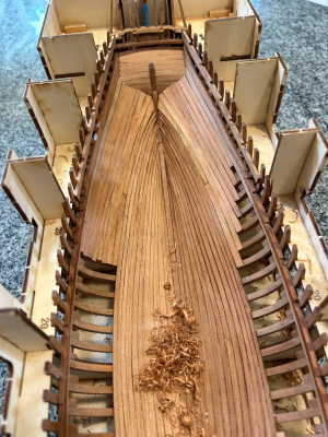

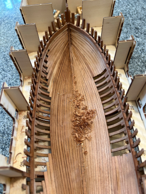

Next are the ceilings. The parts are laser cut and after a bit of consideration, I have just layed them as is. The Boudroit drawings show a limber board and some thick stuff about half way up, but I didn’t want to complicate things. I also found that the first plank sat nicely against the keelson after a little bevelling for and aft.
I made a few clamps for this using a pattern suggested by Bryian. They are made from spruce from the local hobby shop and I find they do a much better job on internal planking than trying to clamp from the outside over the jig.
Kind regards

The ceilings are all in.
As you can see, I have opted to make the unplanked section on the port side slightly larger than in the plans by staggering the plank length rather than have a rectangular opening. I made my own planks for the aft sections. I think every builder of Le Coureur has had some trouble with this part and I thought it was just easier to do them from scratch. Of course, none of this will be visible when the model is finished.
Kind regards
