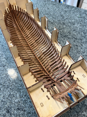

Frames 1 to 35, plus the keelson:
The frames need care to avoid breakages when bevelling as the glued area is decreasing. One or two have occurred, but they have been clean and not difficult to repair. I think overlapping sections of the frames form a satisfying pattern as the jig fills up.

All the frames are now complete.

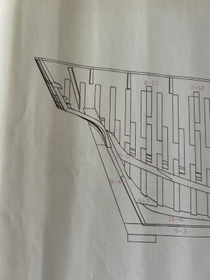

One minor change I have made (compared to some other building logs) is that I have the last frame 40 sitting on top of the lowest horizontal transom timber, rather than on the curved section immediately below it:
I think this is more consistent with the plan:
Of course, this is really of no consequence as everything in this area will eventually be covered with planking.
