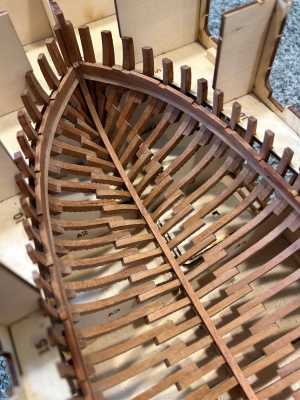

Frames 1 to 35, plus the keelson:
The frames need care to avoid breakages when bevelling as the glued area is decreasing. One or two have occurred, but they have been clean and not difficult to repair. I think overlapping sections of the frames form a satisfying pattern as the jig fills up.

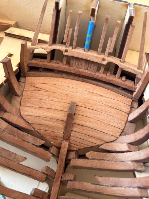

The next job was installing the internal planking on the transom
Then onto the three deck clamps - two running the full length of the hull and one for the aft section:
The bow and stern sections needed some bending. I used a clothes iron and dip the wood in cold water frequently to stop scorch marks. After a minute or so, you can feel the wood start to loosen and then you can start shaping before clamping in place to dry.

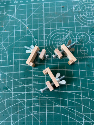

Next are the ceilings. The parts are laser cut and after a bit of consideration, I have just layed them as is. The Boudroit drawings show a limber board and some thick stuff about half way up, but I didn’t want to complicate things. I also found that the first plank sat nicely against the keelson after a little bevelling for and aft.
I made a few clamps for this using a pattern suggested by Bryian. They are made from spruce from the local hobby shop and I find they do a much better job on internal planking than trying to clamp from the outside over the jig.

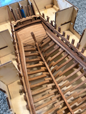

The ceilings are all in.
As you can see, I have opted to make the unplanked section on the port side slightly larger than in the plans by staggering the plank length rather than have a rectangular opening. I made my own planks for the aft sections. I think every builder of Le Coureur has had some trouble with this part and I thought it was just easier to do them from scratch. Of course, none of this will be visible when the model is finished.
Kind regards

Bowwild, it was a nice little project to make a dozen or so of the clamps to go along with the rest of my collection:
You can never have enough clamps.
