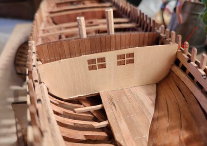

I'm encountering my first challenge since restarting this build.
The starboard side of the aft-most wall (the one with the doors) is a few mm higher than the port side (which is flush with the rail where the crossbeams sit).
It would seem that the floor it sits on must be slightly tilted but I quite sure that the fore crossbeam that it sits on is perfectly level. Furthermore, the aft wall of the ammo compartment also fits almost perfectly (no shaping was needed).
So the question is, how can I adjust the angle of the floor to bring the starboard side down a tad?
