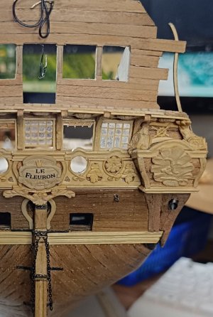

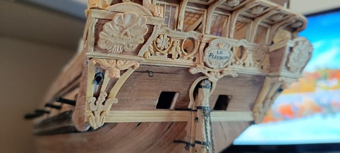

I thought for a long time about what to do with the windows. In the end, I decided to stick with the drawings and leave them ajar. That was my intention from the beginning, so that as much as possible could be seen inside. This means that I will also open the windows on the upper deck in the same way.

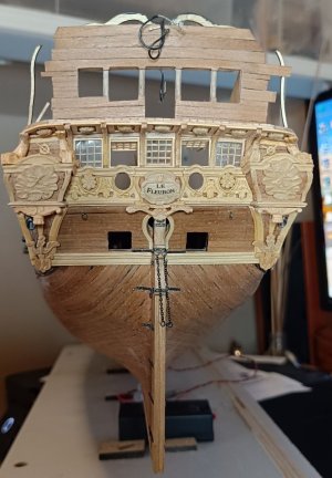

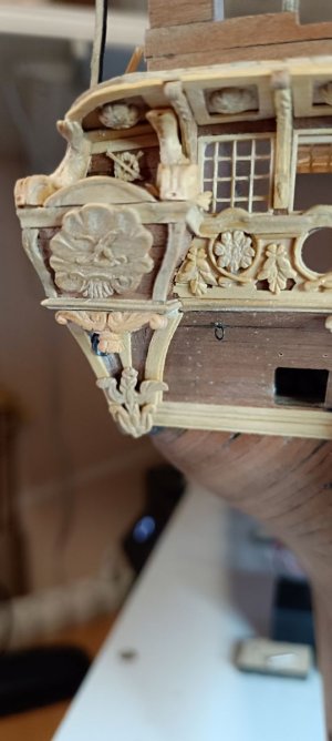

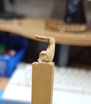

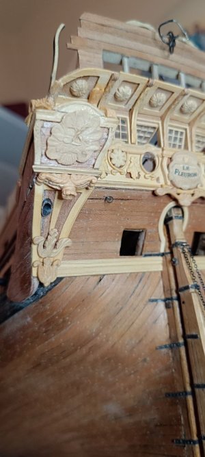

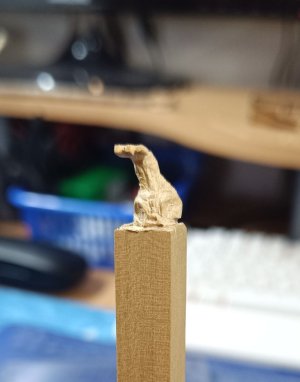

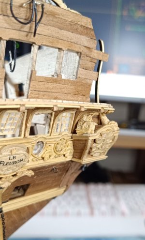

So I tried to cut out the dolphins. The height of the dolphin is cruel for me, only 10 mm.

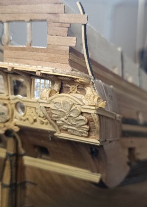

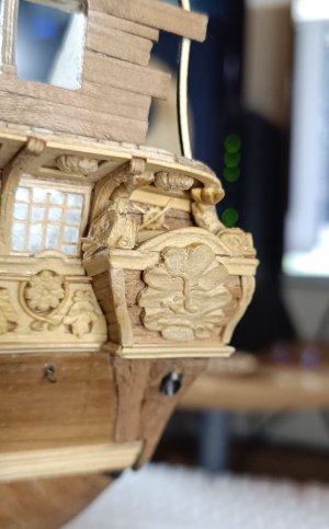

And I immediately carved his sibling out of the boxwood.
I added lilies and added twigs under the coat of arms with the inscription.

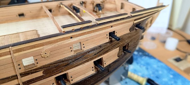

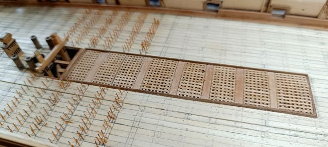

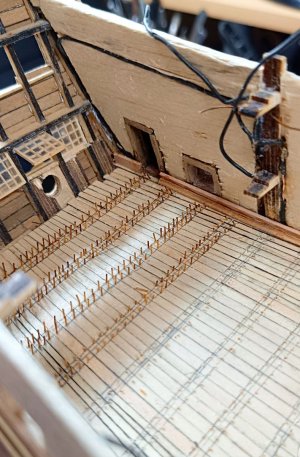

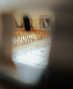

I didn't add anything for a long time, because there was nothing. I worked on the second gun deck and that took a while.
And of course another 4000 nails

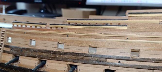

View attachment 565491View attachment 565492View attachment 565493

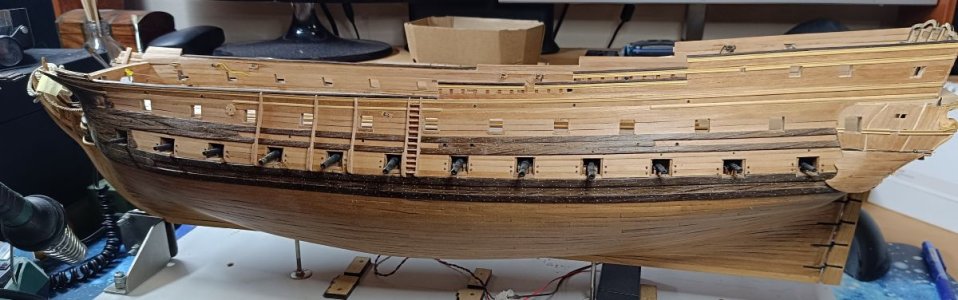

I made a set of internal lining and on the left side also external.
View attachment 565495View attachment 565496

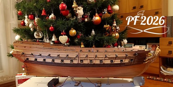

Zdravím všetkých nadšencov fóra v novom roku. Nech je aspoň o trochu lepší ako ten najlepší rok, aký ste doteraz mali.

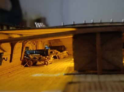

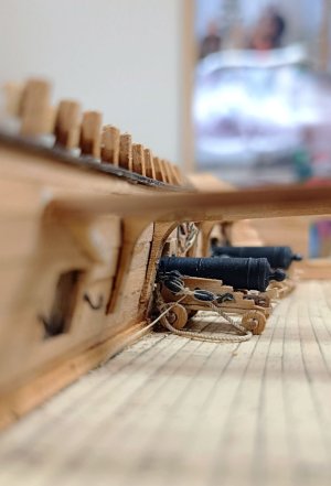

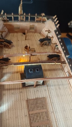

Pokračujem s výzbrojou druhej delovej paluby a zábradlím na prove. Le Fleuron mal 26 kusov železných 12-librových kanónov. Zatiaľ sa mi podarilo nájsť 4 kusy.

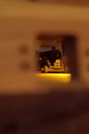

A ešte jeden pohľad s osvetlením.

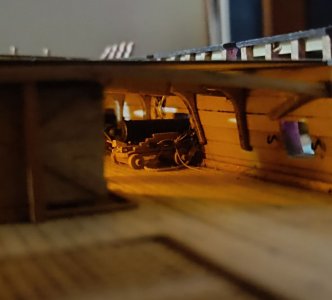

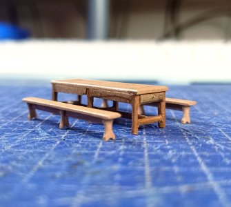

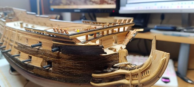

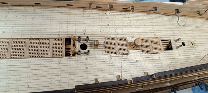

Only 6 more cannons and the second deck will be armed.

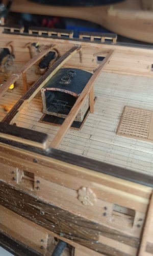

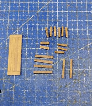

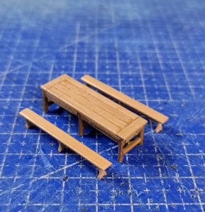

In the meantime, I shopped at IKEY and secured a second table with benches, just like on the first deck, only this one is longer.

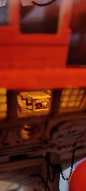

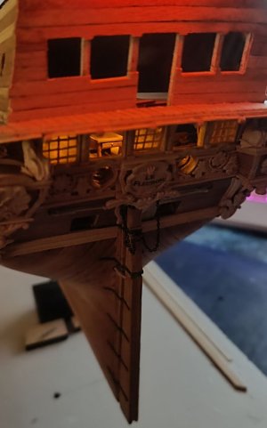

And it's in its place. Finally, there's something to look at.

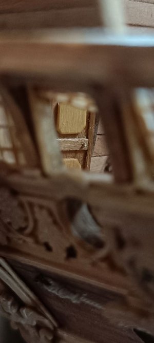

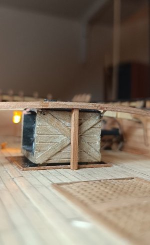

Toilet door
