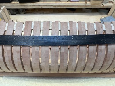

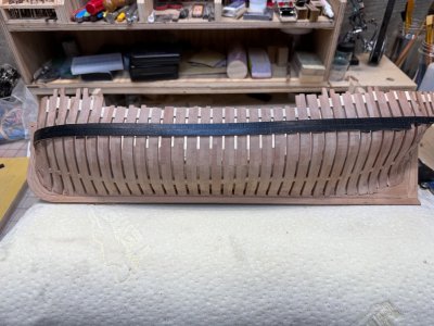

I drilled all the holes for the wale nails (say that three times fast…:)) and completed installing the nails. I think they came out OK. I drilled 0.6mm holes and pushed a 0.7mm brass rod into the holes using a pair of flat nose pliers. That works pretty well and went fairly quickly.

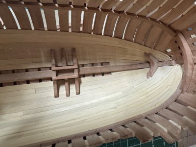

I’ve been slowly working on some interior pieces.
I completed and installed the mast step and dry fitted the first breast hook
Then I fabricated and dry fitted the pump house. I was able to make the hinges but so far the door latch mechanism is kicking my A$$… I may forgo that detail.
I guess the floor sections will be next…

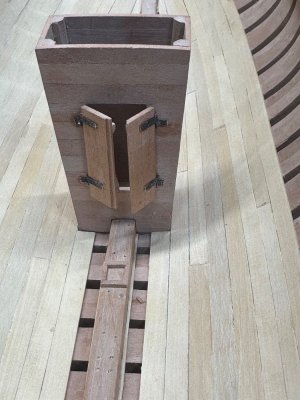

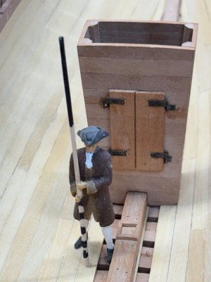

View attachment 547501View attachment 547502

Bonjour Olivier encore bravo pour votre construction :) le personnage que vous avez imprime en 3D devant l'armoire des pompes a eau est ce que c'est vous qui l'avez créer? et serait il possible d'avoir ce stl, bien sur si vous le voulez bien? merci beaucoup d'avance
Hello cool merci beaucoup pour ce partage ,mais je n’arrive pas à accéder à ce forum You do not have permission to view this page or perform this action.
Hmmm, ok, I’ll put them in a zip file and PM it to you. If that doesn’t work PM me your email address and I’ll send it to you directly.

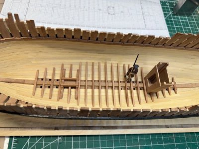

I’ve been working on the interior floor and finally achieved a measure of success in laying the beams.
Now I’ll see how well I can complete the floor planking. I’m only doing half the floor so the ballast and beams will be visible on the “open” side. I’m still debating on how much to open the side. I think it will depend on how the inside turns out and how many of the mistakes I want to reveal! ROTF
Looking awesome...you may have to "open" the entire side to show your "flawless" work!
The flooring beams are perfect for the inspector walk on carefully, while conducting his rounds!
Love the bolts in the keelson! Is the spacing of those bolts, different than the spacing of the frames?
