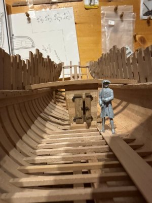

A bit more work on the interior. The main floor is installed but I did forget to install the limber boards under the floor beams and now I can’t figure out how to get them installed without taking everything apart! :confused::mad:
I may simply not install the limber boards… we’ll see.
I also got the forward wall and mid-deck floor assembled and dry fitted.
That’s all for now. I’ll chip away at it tomorrow, time permitting.
Have a good evening all!

moi je les ai pas mis d'un cote volontairement comme toi, pour voir la quille et je trouve ça bien

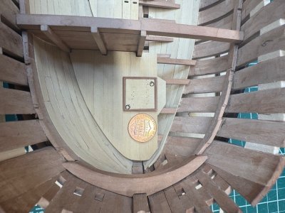

Well, this is all I’m going to say,
Trying to make parts the size of a US Penney with fingers the size of Vienna Sausages is quite a challenge!
It took 2 days and much swearing to make one little hatch! I must continue to convince myself that this is fun!
Onward, my friends into the breach…

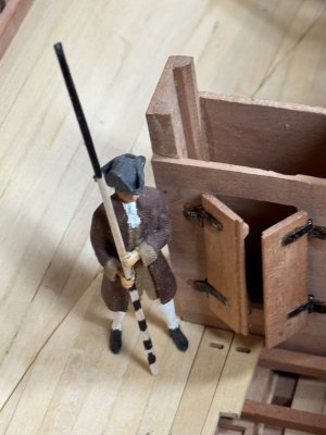

I completed the rebuild of the hinges for the pump house doors.
However, I give up on making the latching mechanism. There is no way my shaking sausage fingers can achieve those small details. So. I’m on to making the deck beams, carlings, and hatches…
Fair winds to everyone!

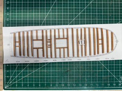

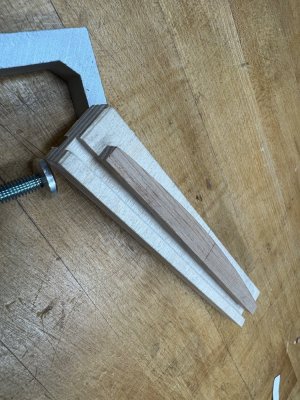

I’ve been working on the the deck beams and got them all cut to size and fitted.

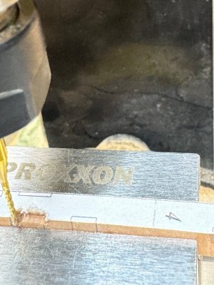

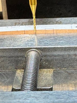

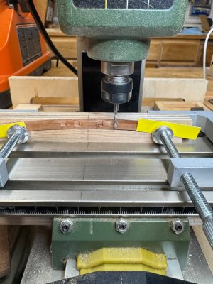

I spent some time figuring out how best to machine all the mortises for the various hatches, carlings, and other pieces that will tenon into the beams. I thought I was being clever in making a backstop with an appropriately curved support…
It turns out that it wasn’t very clever since the cut mortises are 90° to the table and not to the beam’s curve.

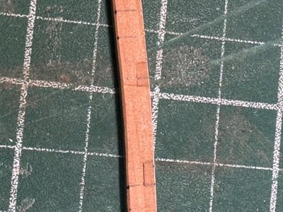

So back to the drawing board. I plugged the incorrect mortises and then drew layout lines on the beams.
Chucked the beams into the vise so the cutout area is square and recut the mortises.
So far this seems to work as desired. We’ll see as we move along…

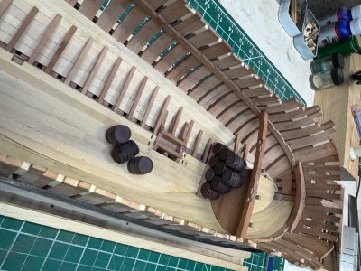

I decided to add a touch of authenticity to Le Rochefort. Since it was a gun powder supply ship, I made some powder kegs and stacked them in the hold,
Just a little fun for me… :D
Now I’ll work on completing the main deck beams and getting them installed.

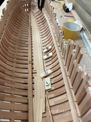

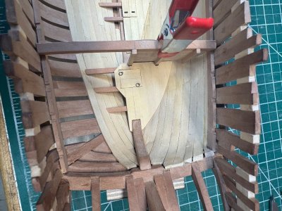

I was making a mess of the deck clamp trying to make the dovetails for the deck beams. The more I worked the worse they looked and didn’t function at all. Sooooo…. I ripped them out!
And made new deck clamps, deck beams and deck shelf’
I know it’s not correct but a gave up on the dovetails and simply cut a rebate in the deck beams and notched the deck shelf.
Now the beams are looking better and laying out correctly.
I do need to remake the carlings around the main hatch (built too short originally).
I’m much happier with the end result and since I’m not entering this into any kind of competition, I believe it’s the right solution.
