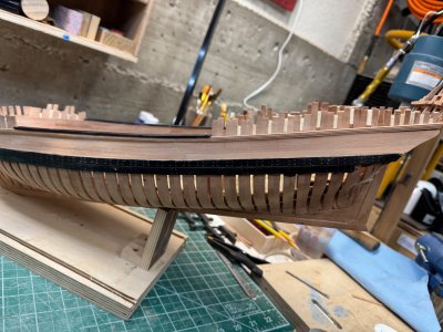

I made this keel holder a while ago but it never worked well for me as it’s to tall. However it worked perfectly to angle the model so I could work on the exterior planking of the lower counter.
More to come as I start planking the exterior of the bulwarks…
Happy Easter every one!
The shipyard is only open part time due to other projects but we’re making progress.

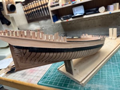

I completed the lower counter planking as well as the outer bulwarks planking. Just a little more fine sanding and some touch up on the black of the wales and counter and we’re off to the next step!
I still have to decide which side of the hull to plank and which to cut open to reveal the inside…
Although, I’m struggling to actually remove any of the frames… instead of FOMO I may have FOFU (fear of f..ing up!) :eek: ROTF ROTF
Ok, I made an executive decision and picked the side that will be planked so onward we go…

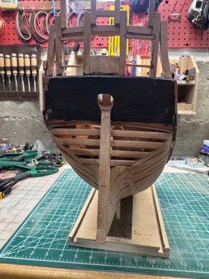

I formed the center section of the garboard strake following instructions in Adrien’s book.
For the concave side I used a 3/8” dowel wrapped in sandpaper and for the convex side sanded the outer curve with a sanding block.
Then I glued the section in place
I then soaked the stem and stern end planks and formed them around the hull.
I’m pleased with then end result.
Next I’ll work on the next plank up along with shaping the stealer plank needed at the stern. But that will have to wait until next week as we’re off the a wedding this weekend.
