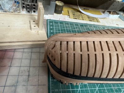

I made this keel holder a while ago but it never worked well for me as it’s to tall. However it worked perfectly to angle the model so I could work on the exterior planking of the lower counter.
More to come as I start planking the exterior of the bulwarks…

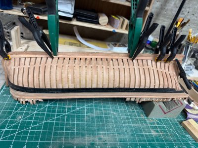

The shipyard is only open part time due to other projects but we’re making progress.
I completed the lower counter planking as well as the outer bulwarks planking. Just a little more fine sanding and some touch up on the black of the wales and counter and we’re off to the next step!

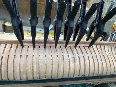

Ok, I made an executive decision and picked the side that will be planked so onward we go…

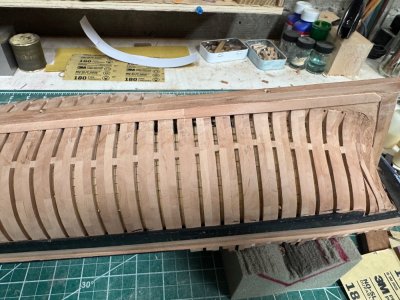

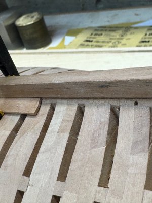

I formed the center section of the garboard strake following instructions in Adrien’s book.
For the concave side I used a 3/8” dowel wrapped in sandpaper and for the convex side sanded the outer curve with a sanding block.
Then I glued the section in place
I then soaked the stem and stern end planks and formed them around the hull.
I’m pleased with then end result.
